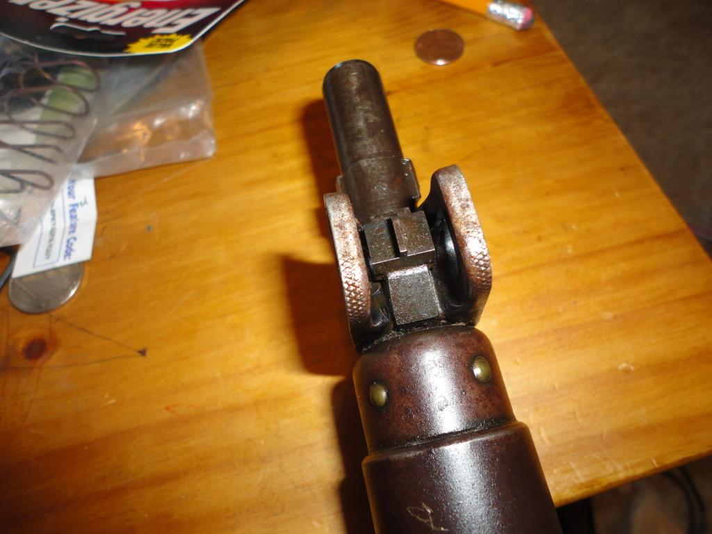

    Hello
    I am a new member.
    I enjoy a Savage No. 4, Mk. I* I picked up a while ago.
    It is a 59Cxxxx SN rifle which I believe is from 1943.
    It shoot about several inches low and to the left with the 2 position flip peep it came with.
    The only options for sight adjustments appeared to be different height front sight posts and drifting.
    I obtained and installed a mircrometer rear sight.
    I do not have any information regarding how to properly adjust this sight.
    I also would be interested to know if there is a better option for an adjustable sight.
    Thank you for any information.

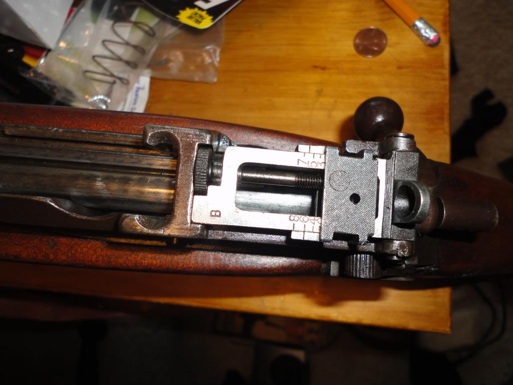

    Thanks, I am good to go with that.
    I am getting at the sight itself.
    It was labeled micrometer adjustable sight.
    I thought it was adjustable for windage and elevation.
    The dial adjusts the secondary peep for elevation.
    But for the main sight and windage am I missing something?

    Thank you for your help.
    The rifle came with this rear sight.
    I shot at about 7 O'clock from point of aim, about ten inches, at 100 yards.
    From reading, it said my options were to change front sight blade heights and drift, at least for the ammo sighted in.
    The other option was a rear adjustable sight.
    I went with this option as I could adjust easily if I changed ammo/loads.
    It was advertised as an elevation and windage adjustable rear sight.
    But it appears only the secondary peep is adjustable for elevation.
    My goal is to be able to adjust point of impact without changing the front sight blades or position.

    You have 2 reasons to send this back to the seller, if you can:
    first, this sight is not windage adjustable (and nor is the No 4 rear sight)
    second because it should be calibrated up to 1300 yds - this is (I think) a No 5 jungle carbine sight, calibrated to 800 yds.
    Springfield Sporters have the No 4 rear sight for $25 or they come up on ebay.
  10. Thank You to RobD For This Useful Post:
    Warren's Avatar
    Dec 2006
    06-28-2025 @ 01:02 PM
    1,221
    07-06-2025
    12:40 AM
    The sight you have on the rear is for a No.5 Mk.I (Jungle Carbine)... It is not correct for your no.4 rifle
    There is no windage adjustment on the No.5 sight nor is there windage adjustment on the No.4 sight unless you go to a target grade sight.

    Also your carbine sight will not go up in one minute steps and you will go crazy trying to keep up with the math.

    Thank you.
    I believe I am going to sell this sight and look for a No. 4 target sight then.
