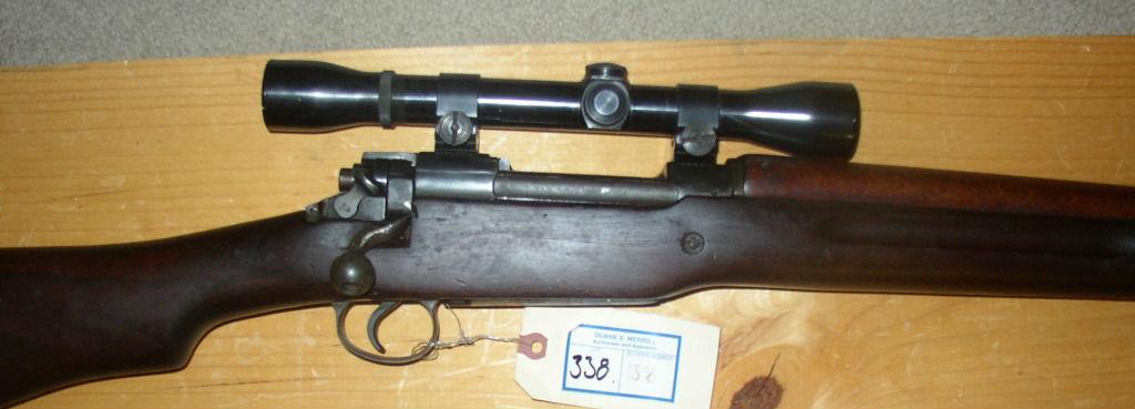

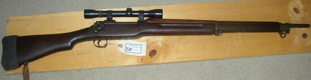

    Few months back I glommed a sported 1917 Winchester. It looked like a workman like job of sporting and was cheap enough...

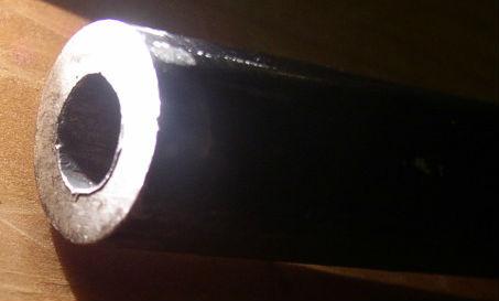

    I stuck a Weaver K4 on this one (didn't care for the United that came with it) and shot it today. The "crown" (or what a gunsmith might laughingly refer to as a crown) is scary looking.
    But even with the scary looking crown, it did ok..threw one to the 12o'clock and one went a bit wide
    Question...should I recrown the barrel and hope for an improvement?

    Legacy Member flygrimm's Avatar
    Aug 2011
    02-22-2025 @ 11:26 AM
    Bethlehem, PA
    41
    05-05-2025
    03:55 AM
    I bet you could see pretty significant improvement. That muzzle looks pretty rough. A quick and fairly easy job. Shouldn't be too expensive either. Don't live close to a gunsmith - then you might want to try this: Muzzle Re-crowning Tool Kit (Manson) - Gun Tool Rentals . For arounf $40 you can do the job yourself and not be out too much cash if the change isn't all that great. The guy who makes the tool has some videos on youtube. I have been considering this for my Patt. 14, just haven't goten around to it.

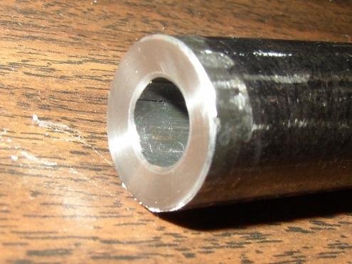

    I recently got the barrel recrowned. The gunsmith recommended a very slight re cut and then recrowned the barrel.
    Much better than the old "crown"
