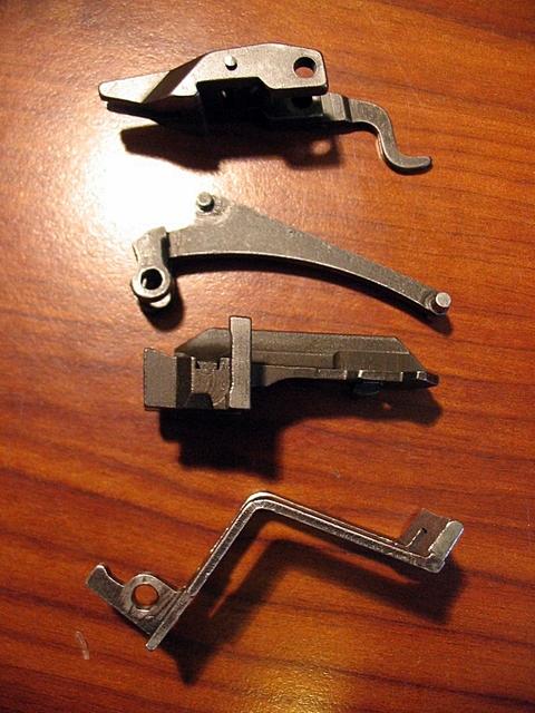

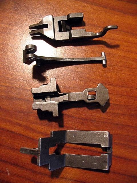

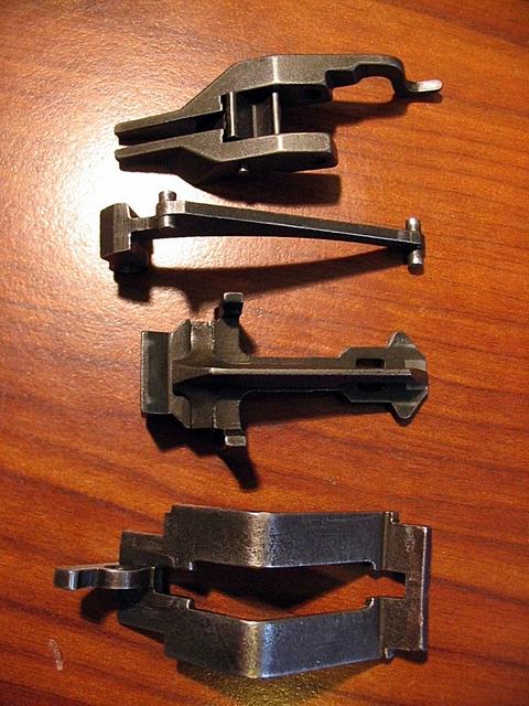

    Hi all.
    These are the internal parts of my Springfield Armory M1icon Garand dated 1954 Serial #5,453,xxx
    I wonder if the following internal parts are correct for the make, year of the rifle.
    Operating Rod Catch / Follower Arm / Follower Assy / Bullet Guide
    Please let me know, should any of these parts be wrong, which should be the correct ones instead.
    Thank you.
    Here are the pictures :
    Salu2 a to2
    Bizio

    That rifle should have a bullet guide that is stamped, with a clearance notch, yours is milled.

    Thank you, do you know someone who can sell and ship one to Italyicon ?

    Notch
    That's not a clearance cut, it's an ID notch to identify the taller fulcrum on late guides.
