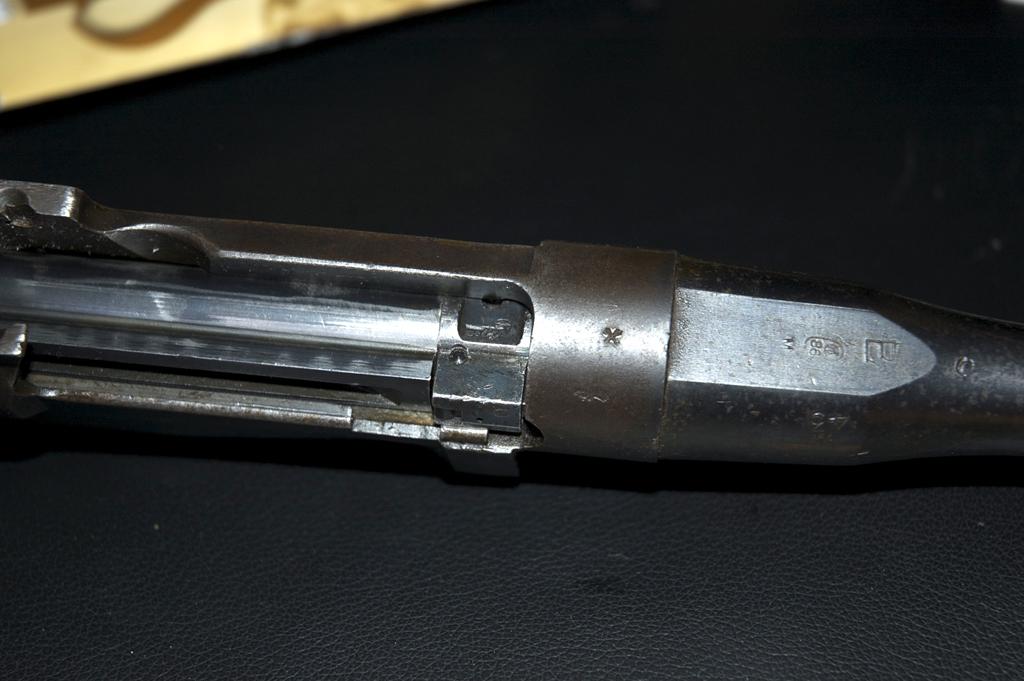

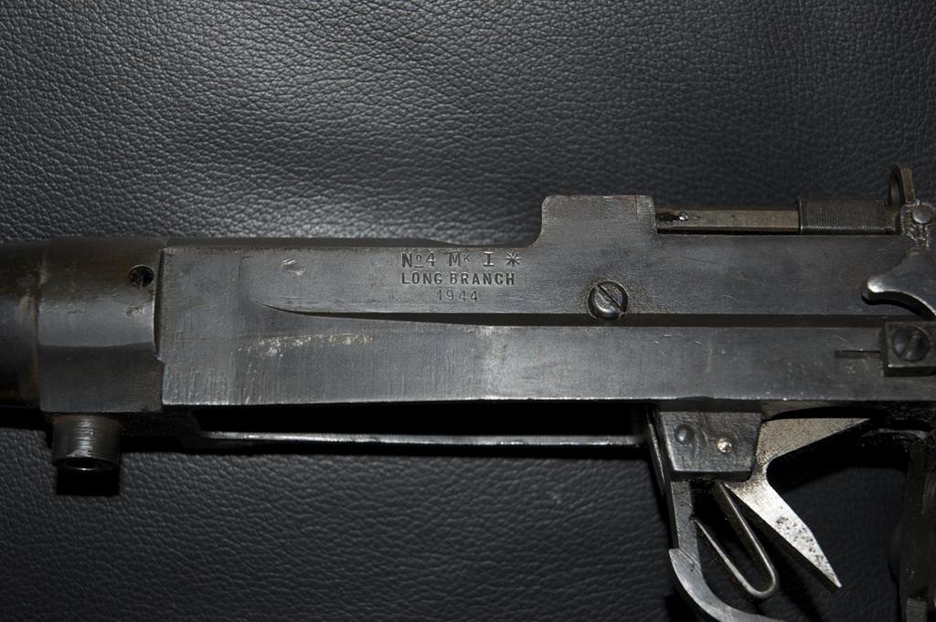

    Hi,
    New here and new to Lee Enfield.
    Was hoping you guys could take a look at this barrelled action and help me out with some markings. The wood is off right now, it looks to be either part of an FTR or just plain repro. The front wood is definitely older, the butt stock looks brand new, probably walnut, but I can't tell what the forestock wood is but it's a lighter orangy brown.

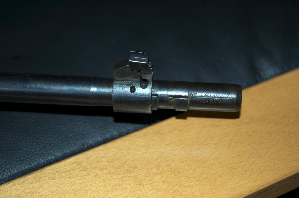

    I know it was "sold out of service" as it's stamped NP (or WP) 3632 22 185T0NS (or 5 not sure) at the end of the barrel by the bayonet lug. I don't have pictures of the bolt, but it doesn't match the reciever and has no serial number. It has Long Branch stamps on all parts except for the bolt handle which has a C-broad arrow on the ball and an A stamp on the front of the handle. The sights are MkIII, stamped I think.

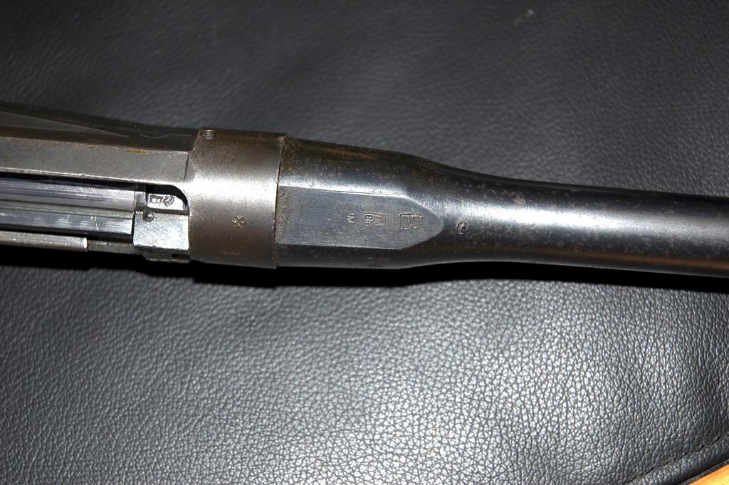

    I'm mostly wondering what the X stamp means on top of the receiver ring ? Looks to be a 43 dated barrel on a 44 dated receiver.
    That's everything I know by looking at markings and searching the net.
    Thanks for any info !

    Looks like you have a project there but it looks like a good one. The X on top of the receiver means that during an inspection there was rust found in the bore/chamber of the rifle. It was treated at that point and the mark was a signal during the next inspections to keep an eye on that barrel for the rust to have come back. Post some pics when you get her back together,

    Thanks for the info ! The bore looks pretty good, no pitting and I can't see any rust, so hopefully it was taken care of.

    Just a correction for the "sold out of service" stamp... it actually says NP (or WP) 303 2 22 185 TONS. I learned a little more about it and realized it's denoting the calibre, cartridge length and max barrel pressure (at least I think that's what the 18.5 Tons marking means).
    I couldn't edit my original post so I'm correcting it here.
    That is nothing to do with "sold out or service" as such. It is a Britishicon civilian Proof. (The Gunmakers Company, London, in fact.)
    All firearms sold in the UK must be Proofed. However the Government is exempt. Therefore if one wishes to sell an ex-Government firearm in the UK it must be Proofed first.

    Hmm..ok. But it's a Long Branch....does that mean this rifle was in the U.K. at some point ?
    More research...I see now that the first marking is "NP" under a crown which I believe means Birmingham Nitro Proof between 1912-1954.
