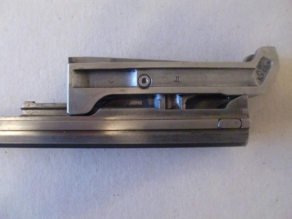

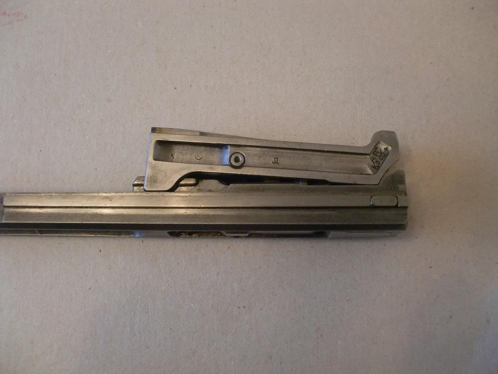

    You effectively have the bolt in the locked position but as you dont have a locking shoulder fitted (Being a late deac) the bolt has moved into the locking shoulder recess. You need to tap the bolt forward, not the bolt carrier, just the bolt. It may take the bolt carrier forward too but that is fine to start with, get everything back to the correctly locked position and it should all free up.
    Here are some photos to help show whats going on, the top one shows the bolt has ridden up the locking cam and is 'UP' or the locked position, the lower photo shows the bolt in the 'DOWN' or unlocked position.

    The reason this has happened as described by BP. Is that on later Deacts, part of the 'Updated' Deactivation specs. Require that a portion of the Lug that the breech block sits over. Has to be ground out. This in effect remove an area that would strike the firing pin on a Live firing example. On the deact, this effect has been nullified due to the metal removal on the hammer face of the piston post. It is simple to rectify as also described by BP. But use a BRASS drift, so that you don't damage anything when using the 'Birmingham Screwdriver'! (Hammer)
