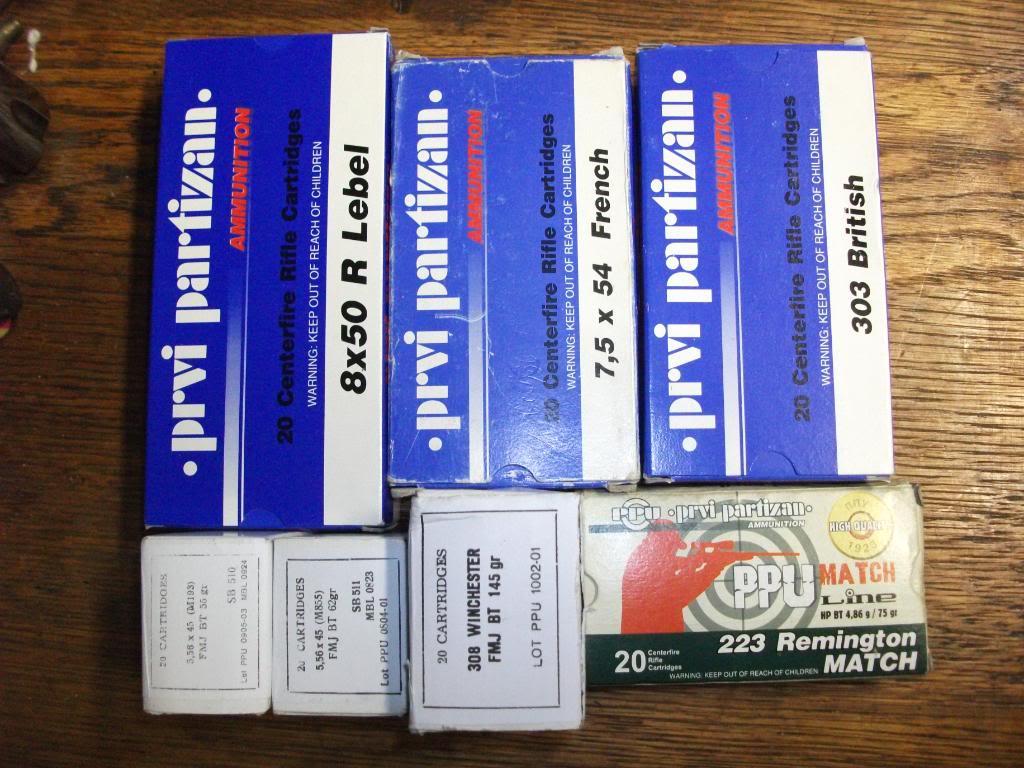

    Ammo is not commercially made for this rifle and to my knowledge never has been.
    Pvri Partisan currently manufactures said ammo.
    Random PPU ammo photo with 7,5x54 in the middle:

    Now that is good to know. I wonder if RCBS makes dies for it yet.
    If they would only start making 7.7 Jap I'd be all set.
