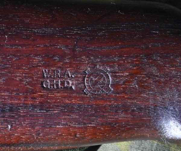

    What appalls me is that 50 years from now, all the "put together" cr@p carbines and carbines with faked, humped parts will be accepted as "the real deal!" And by the way, here's alate Winchester cartouche. MUCH smaller!
