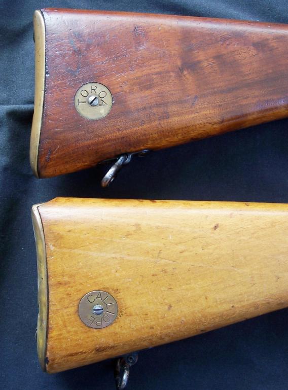

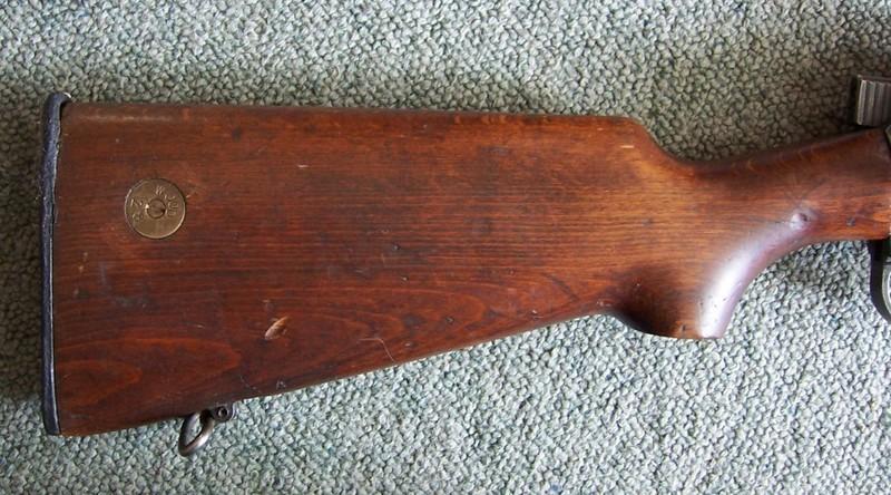

    Discs are common in the NZicon Cadet rifles No4s & No9 & the location is similar, some of the NZ No8s also have discs.
    A pair of No9s
    No8
