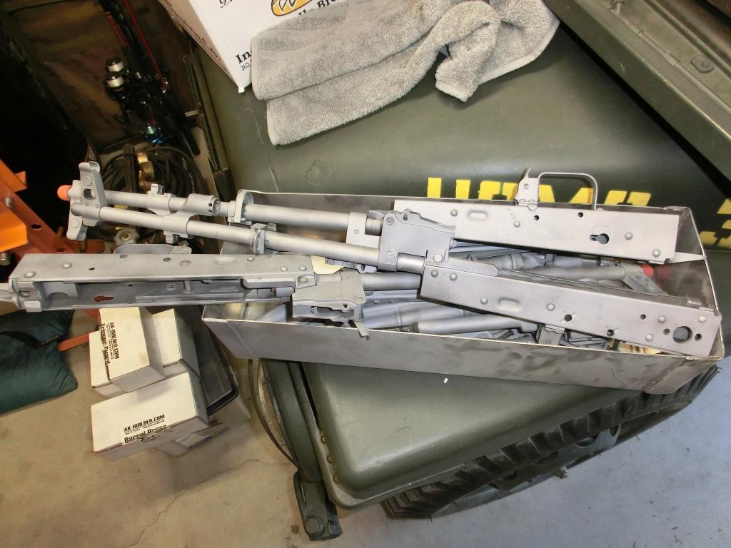

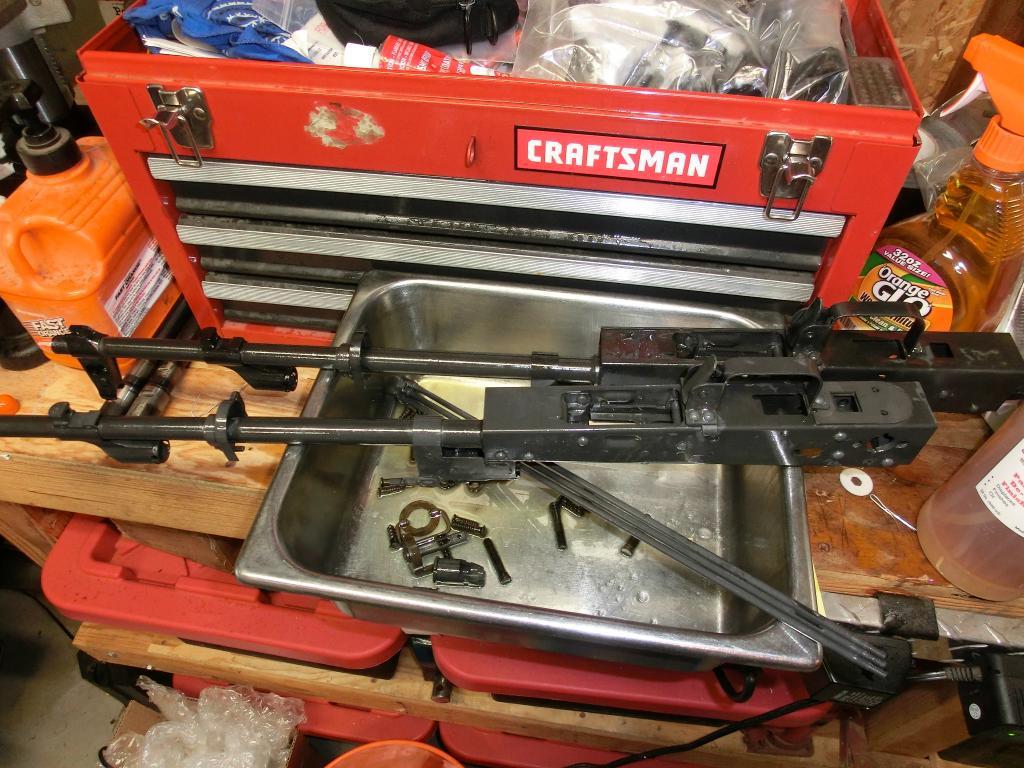

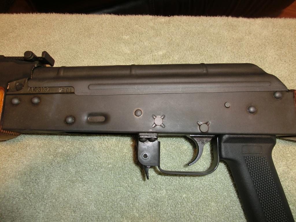

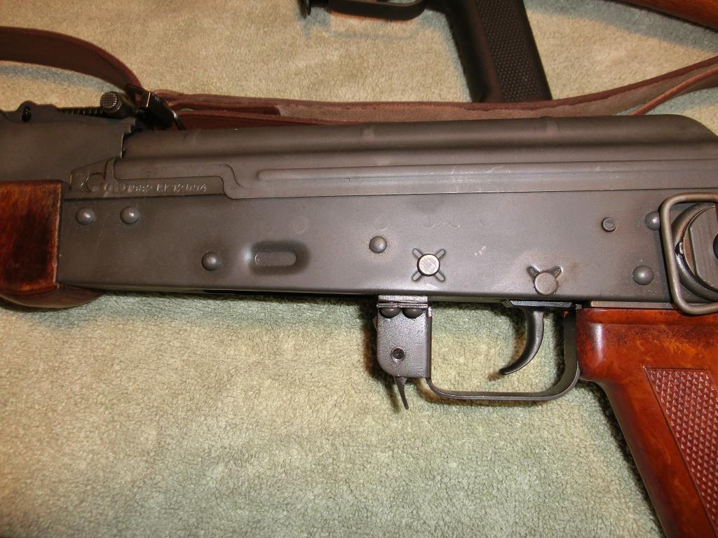

    This is from yesterday afternoon. All the parts of three AKs are bead blasted and ready for degreasing:

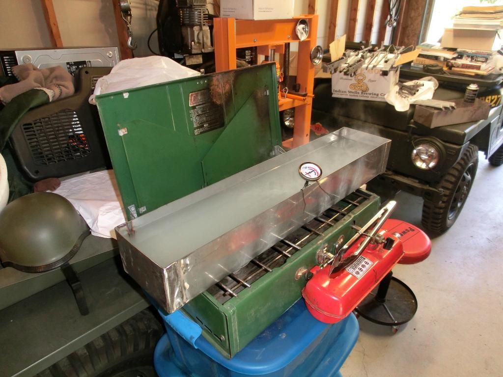

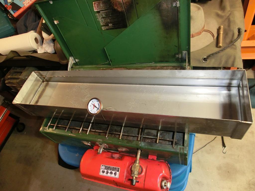

    Getting the stainless pan going on my 50s vintage Coleman camp stove:

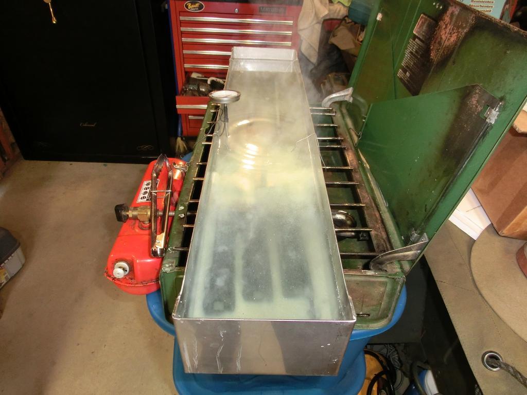

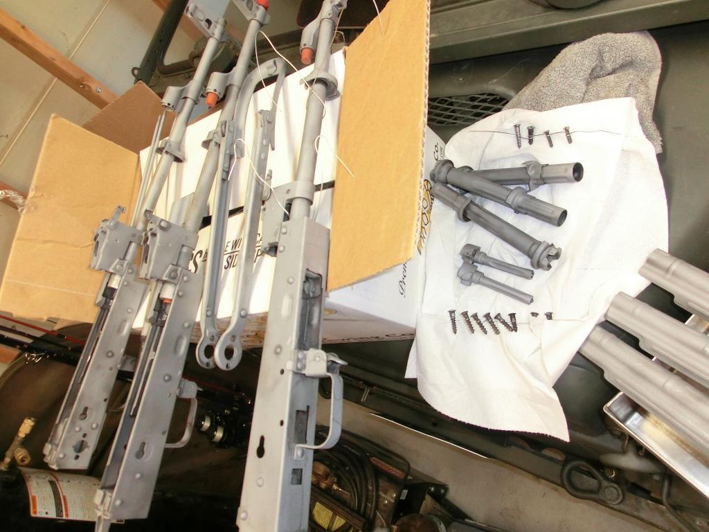

    Parts are degreased and reading for dipping:
    It's getting there! A watched pot never boils

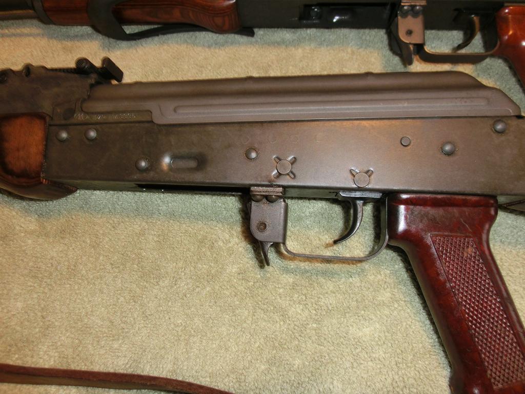

    One really keeps hopping once you start this. Here's one and two:
    Here are some bits and pieces like top covers, safety levers and such:

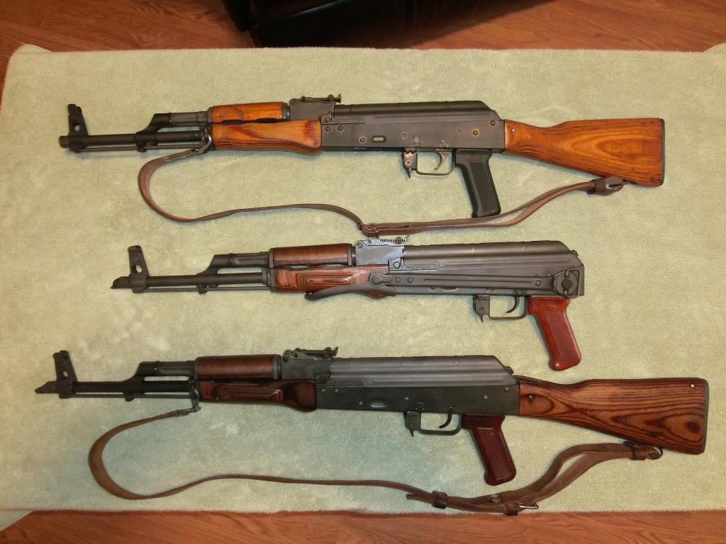

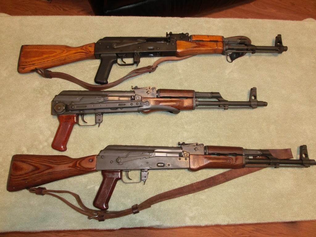

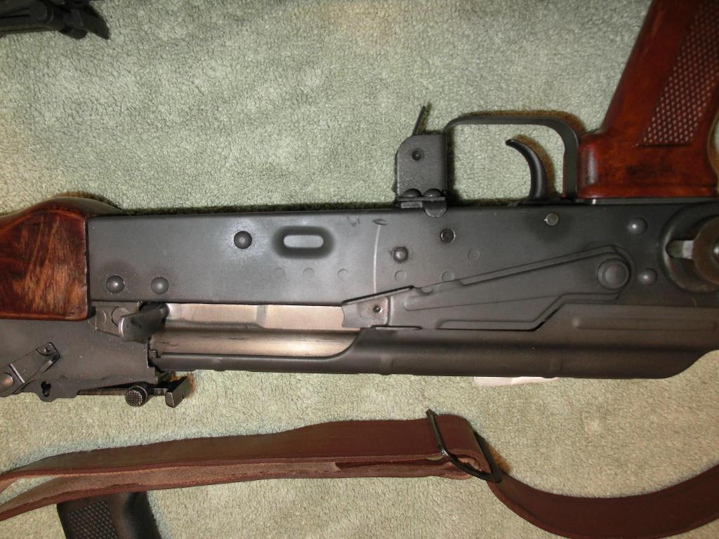

    All three put back together this morning after soaking in finishing oil:

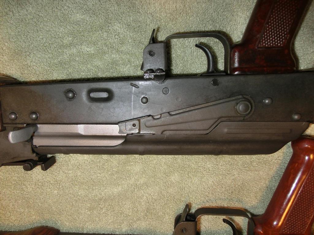

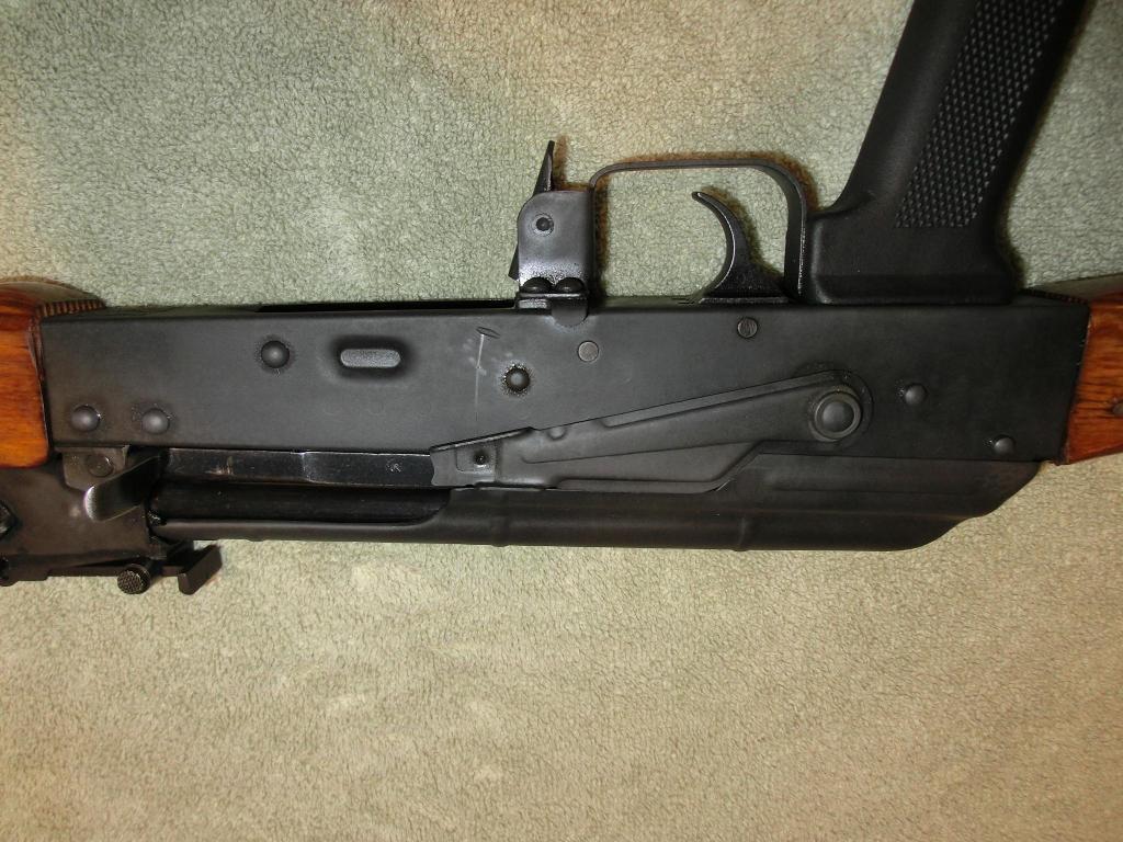

    Some little detail stuff I did was remove the front sight pins, rear sight leaves, hammer and trigger pins and I blued those. I'll take some white paint and do up all the numbers on the leaves later this week.

    Nice setup, you get great results, I kinda feel like I took the "short" bus to school.!! Never thought to use my Coleman to heat a tank.

    Pretty funny...a two burner for Park...We always used a full propane burner rig for all that. I knew you could accomplish great things with modest means. And yes, you definitely have to get busy once up to temp or the next thing things are scaling up or turning green or red. I also see you set your work in the bottom of the tank. I was taught to suspend mine in the middle...I think it was to avoid the scale buildup from Parkerizing solution. Yours looks brand new though and we had a batch that sat indefinitely and would be added to. That would make ours less simple to use I should think.

    I've never Duracoated before. A lot of AK guys go that route but being it's a gun of steel and wood, it deserves either blue or Parkerizing.
    The only pieces I set on the bottom of the tank were the top covers and the safety levers. I was able to set them on the edge and all was good. The top covers are very thin edged so they worked out well also. Jim, I bought that camp stove for $5.00 at a thrift store in Walker, CA on the US395. Best $5.00 I ever spent
