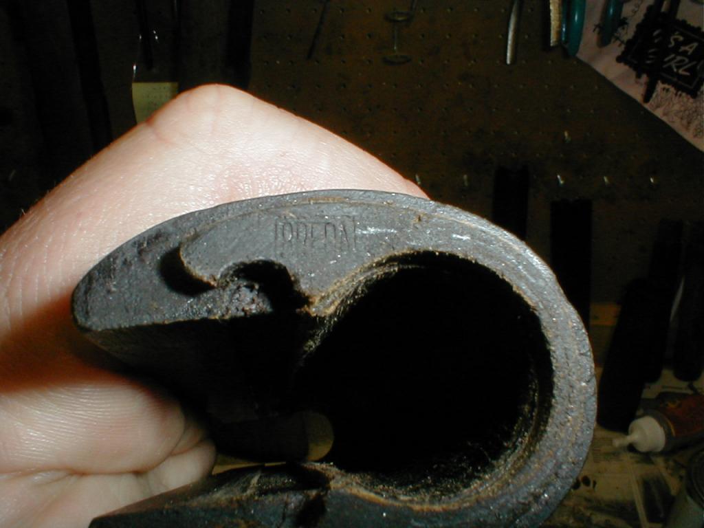

    Ferrule
    Dunno for sure, but Beretta marked theirs so I'm guessing Breda did too.
    Attachment 46501
