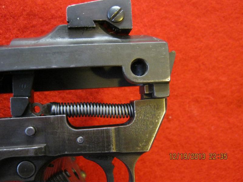

    gunsdora,
    Is the shoulder where your receivers locator/tooling hole is... Rounded or Squared edged?
    I think you'd have the Receiver Type B, variation 1 (rounded). Used early in the first and 2nd serial number blocks.
    2nd block... 3,21 to about 3,25 IIRC (these are rough numbers. But after these is when I believe they started using the square shoulder (Type B variation 2). Later yet some were found with no tooling hole (made at the Saginaw, Mi plant, marked SG on the lft side of receiver (Type B variation 3).
    Taking a guess..... I'd say a 8 or 9 of 43 barrel.
    As far as barrel maker? Seem to recall with the free barrel issue program, that S'G' used Inland, S.G. Buffalo Arms, Some Rock-Ola and of course Underwood barrels.
    I'll try to research it closer if no one nails it for you.
    Remember SG took over operations on April 1 1943 and used up (I believe bought up) any approved extra parts etc.
    I'm rushing here on a always tough for me to answer question (any IP, S'G' S.G. gets iffy for me) So don't rush out and make some big $$ purchase because of my info
    Cheers,
    Charlie-Painter777
    Picture of rounded shoulder on S'G' 1,823,xxx

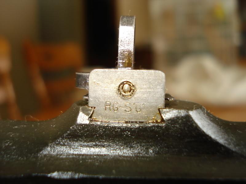

    I should note that the rear flip sight on the receiver I pictured above is a REPRO.
    It was sold to me as such.
    I don't dare try to remove it in fear of breaking off the edges of the dovetails.
    When Bubba put the FAKE on, he peened the edges over, making IMO any attempt at removing too dangerous.
    Worse part is there are no round stake marks from a previous Adj rear sight.
    I have pictured comparisons along side a real RG-S'G' rear flip, but don't want to post.
    Below is the fake on my S'G' 1,823,xxx
    Charlie-Painter777
