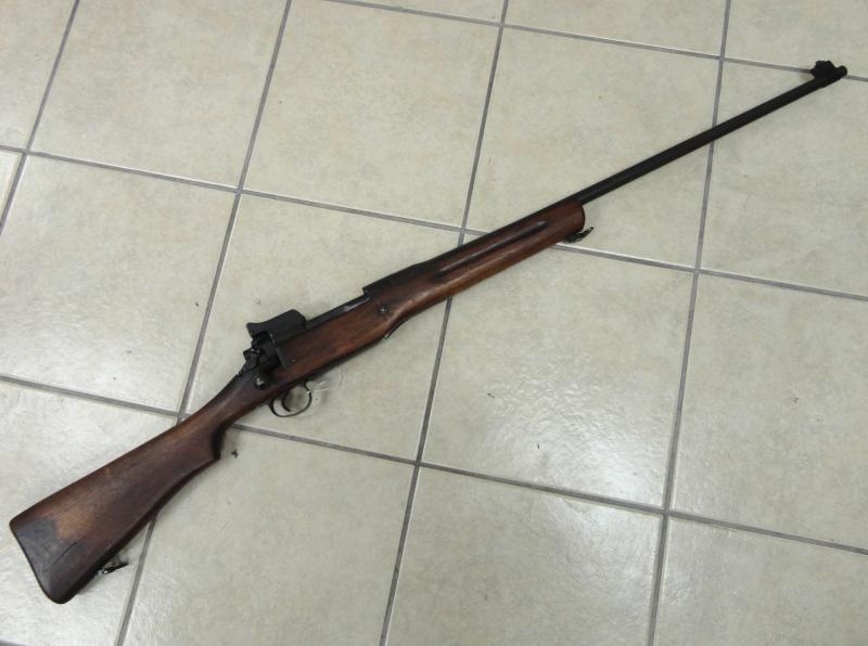

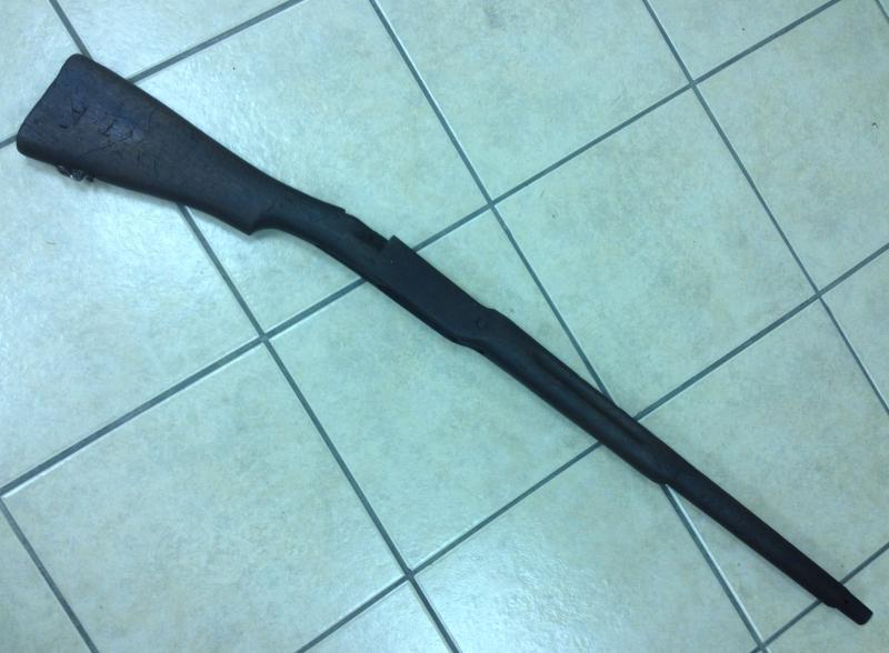

    Here is my latest project, fresh of the pawn shop. I just couldn't pass her up no matter how hard I tried After some horse trading, I ended up taking her home. I only have $100 in the rifle (so far!).
    Here are some pictures:

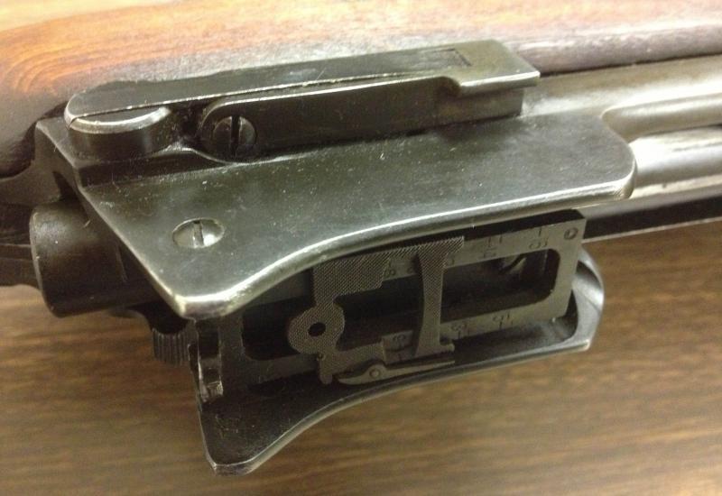

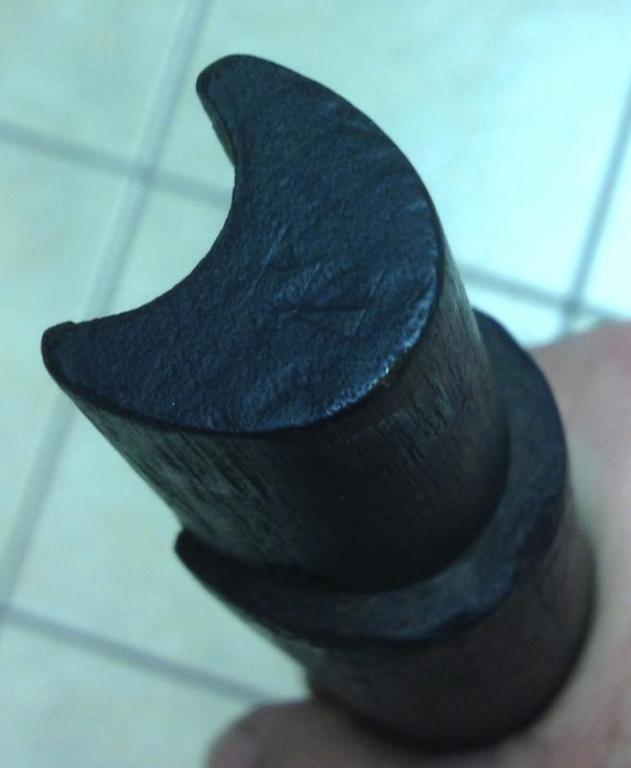

    Budda did cut down the stock and remove the front ears but those can all be replaced of course. The barrel and rear sight wings are all intact which is the best news!

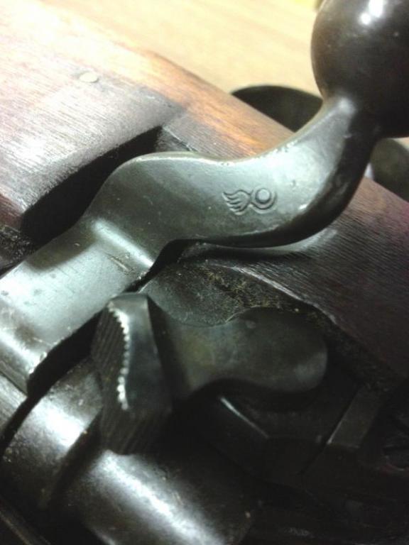

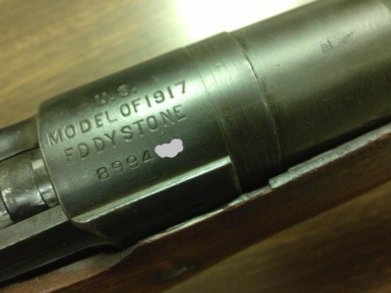

    And just a few other shots showing the flaming bomb marks on the bolt handle and left side of the receiver:

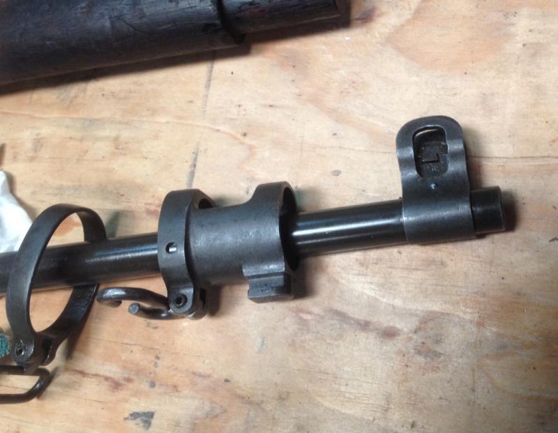

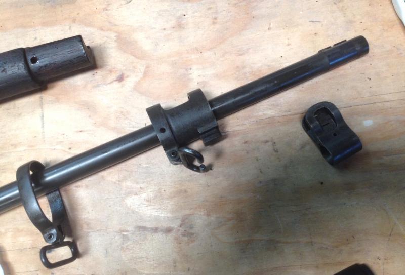

    Just this week, I got the itch to tear my new M1917 down and check things out and clean her up some.

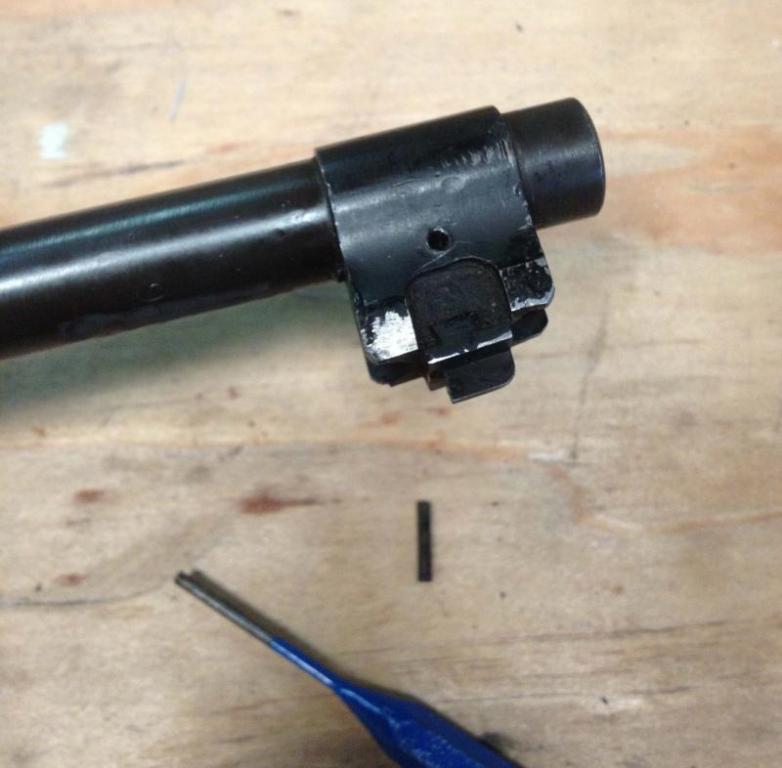

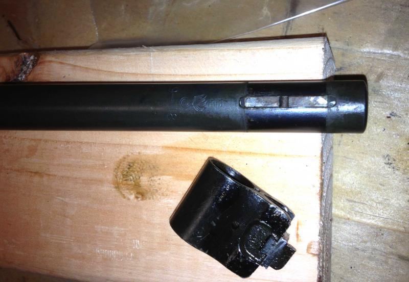

    The first thing I did was drift out the pin to remove that butchered front sight. Thanks to a friend on another forum, I already have the correct front sight with ears, yeah! The only small problem may be the blade height. The one on the gun was stamped .060 but the new one is marked .090...

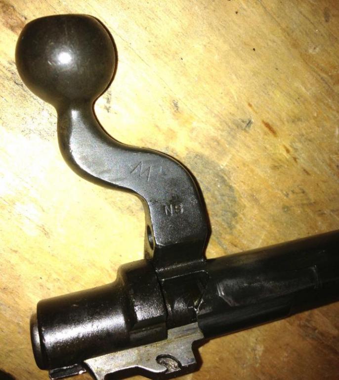

    The bolt looks to be all Winchester:

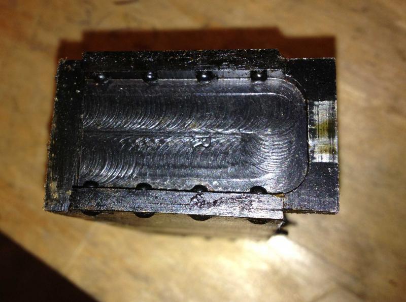

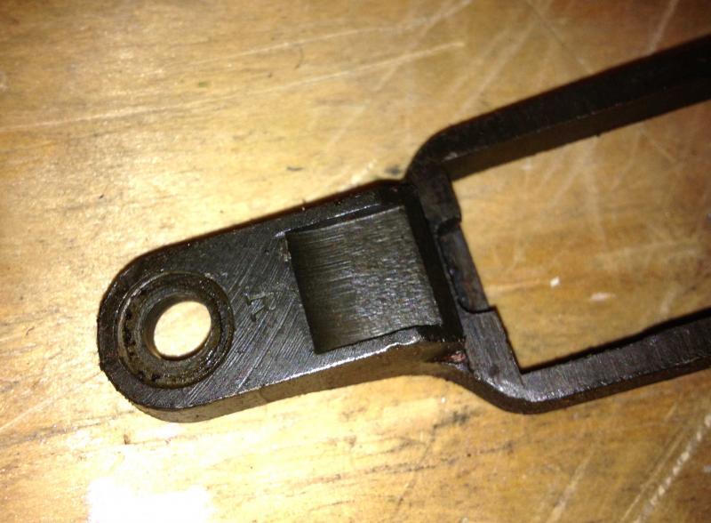

    The trigger guard plate and magazine box are both Remington "R" stamped:

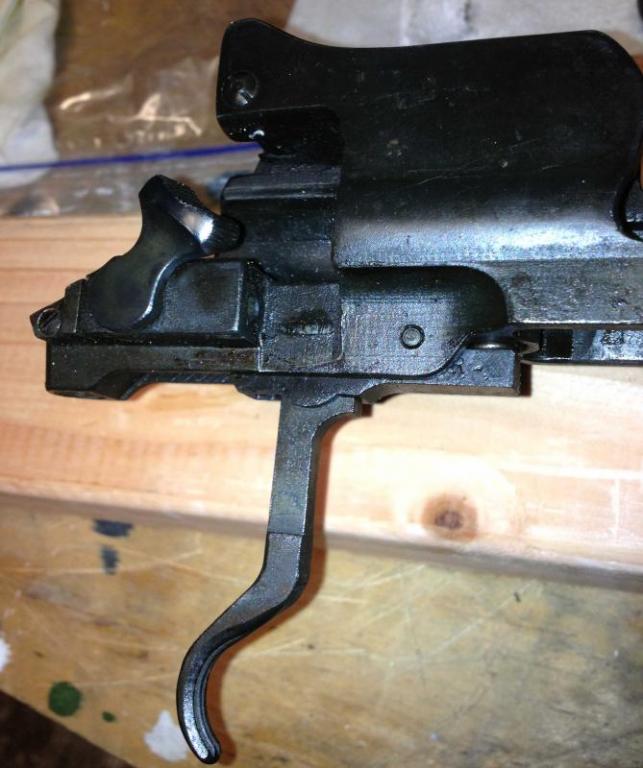

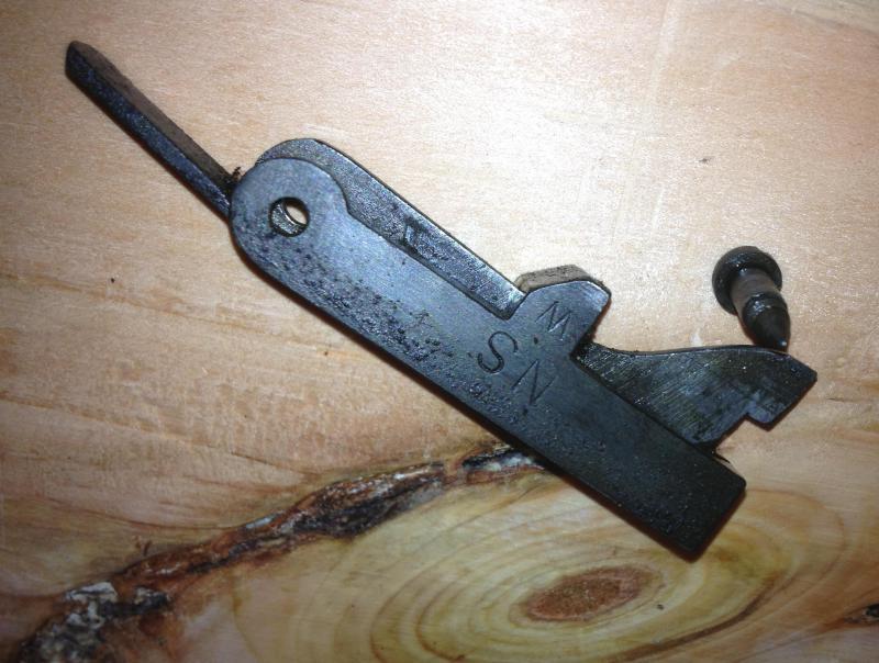

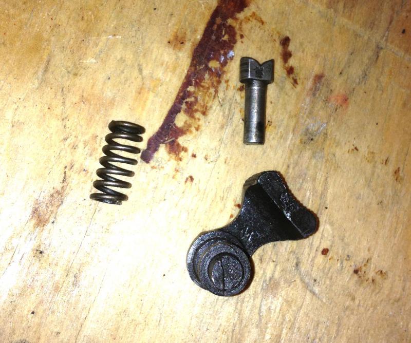

    The trigger doesn't appear to be marked, but the sear and safety lock holder are both Remington (you can barely make out the "R" on the sear in this photo):

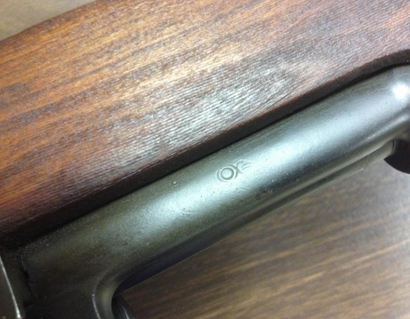

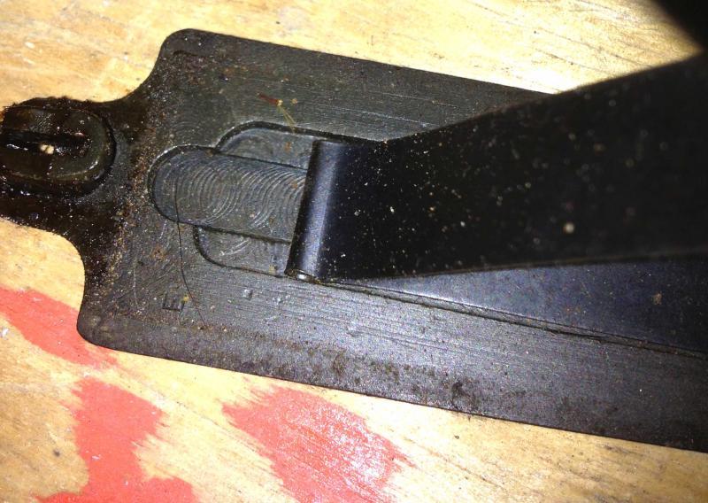

    At least the magazine floor plate is Eddystone marked:

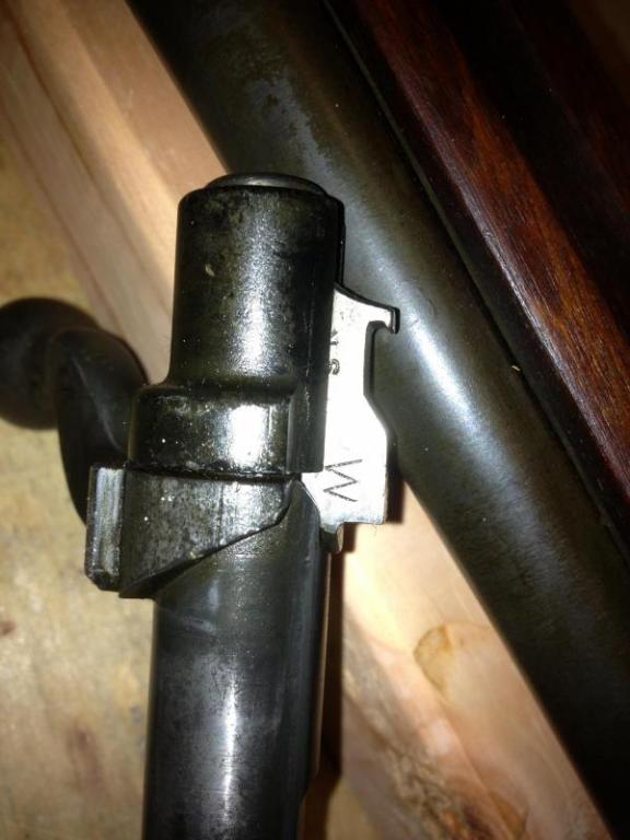

    The bolt stop and ejector is Winchester as is the safety catch. Although I couldn't get a good picture of it, the safety lock holder is stamped "R" for Remington!
    So I guess at this point I could could just find any old stock and then put her back together and hit the range. I know that finding the correct stock is going to be by far the toughest and most expensive part of this restoration.
    But thinking it over, I am leaning towards replacing all the incorrect parts with "E" stamped Eddystone parts. Eddystone parts seem plentiful and not too tough to track down. I could then turn around and sell my extras when I purchase their "E" replacements to make my money back. The only potential problem I see would be with the bolt. If I replace it, I won't know if the headspace is correct or not (I don't have the gauges)...
    More later as I track down the parts. I think it really all depends on that stock...

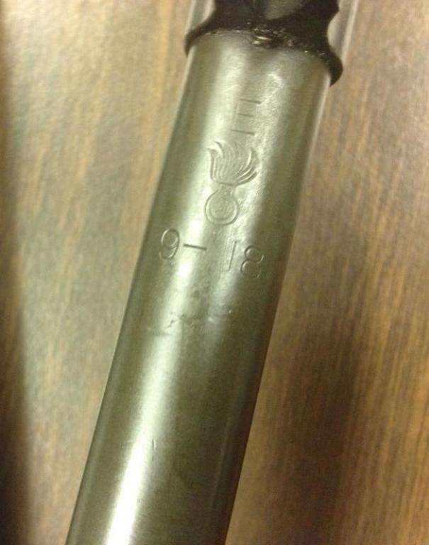

    Thanks for the reply Chuck. I'm curious as to why you think that the barrel is a replacement? Does the s/n range on the receiver not jive with 9-18 barrel date? It seems pretty close in the books I have and what I've seen on-line?

    barrel should be June July of 1918.
    by Sept Eddstone was parkerizing rifles.

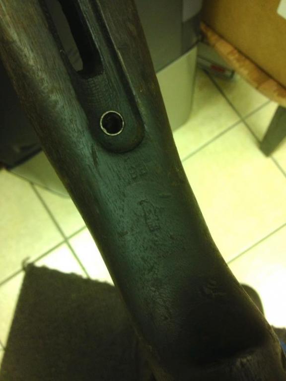

    Well in the almost 5 months I've had this rifle, I'm been using mostly eBay to find the correct Eddystone parts for her. Last week, I scored an Eddystone stock. She has lots of "character" marks but I really like it. No refurb stamps either. Here are some pics:
    The stock was pretty grimy, so I wiped it down with BLOicon and it feels and looks a lot better. I've been tempted try the iron steam method to bring out some of the dents but I'm a bit chicken I must admit...

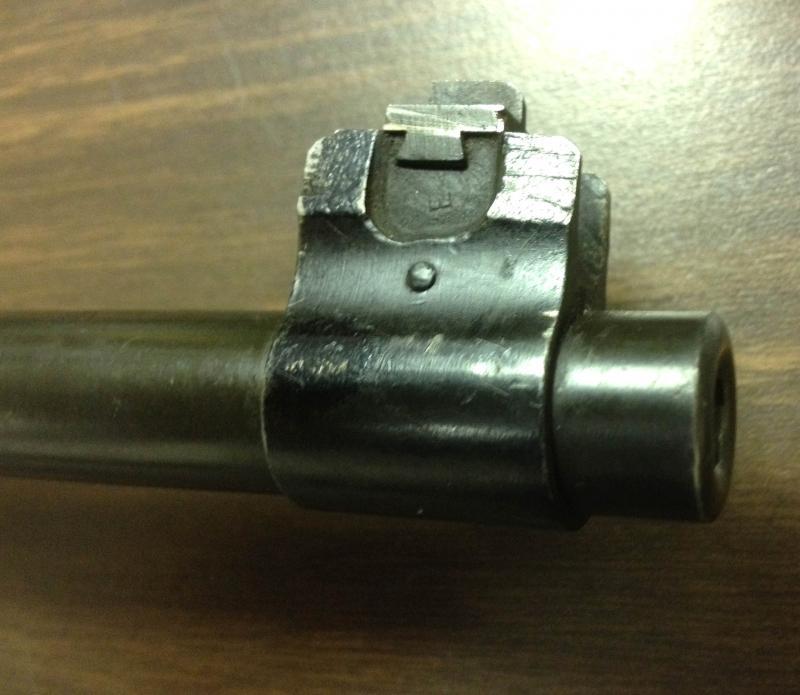

    And then yesterday, I took my barreled action and slipped on the hand guard ring and both barrel bands. Then I took my new front sight (thanks once again Rick) and carefully reinstalled it. That was a good feeling:
    I've almost got all the Eddystone parts I need. This week, I'm going to order the magazine box, trigger guard, and floor plate catch from Springfield Sporters. Once I have those three parts, I will be able to put her back together.
