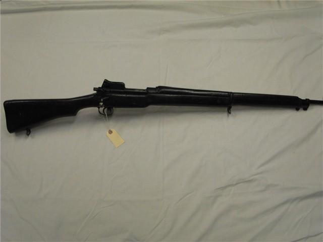

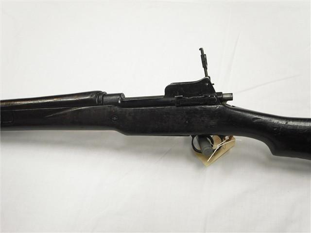

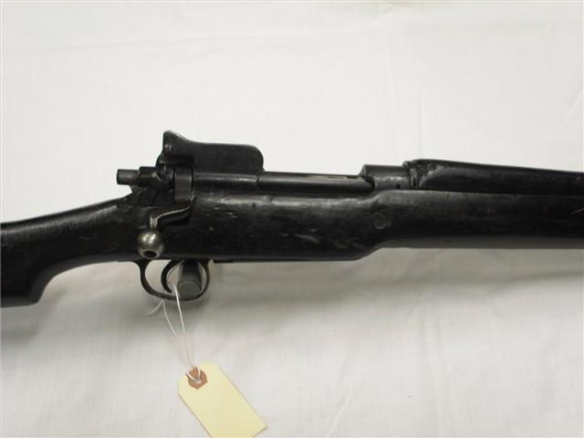

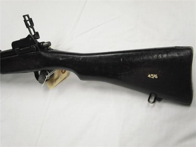

    From the seller; not great quality images. BUT I like the old dark looking wood, however it got that way, God or man.
    I inquired as to the receiver stamp, he responded "RE" in an oval. He said volley sight is, of course, missing. Has been "removed". Told him I would buy a replacement from Numrich and tried to get him to knock it off the price he declined, stating he did not see how it would fit? [I believe he said the rear part (aperture) was there.] We took the gun for $400.

    The guy told me that the front volley sight was cut and it has been pointed out to me that the rear volley sight is not there in the images, ergo I think you guys have it. It's a Remington that has been put through the "Weedon Repair Centre".
    Remington receiver and Eddystone wood. Strangely enough, if this is correct, and if what I can glean is true, this is perfect for me. While I own some milsurps, I am not at all familiar with the P14 other than rudimentary reading. It seems that generally speaking, the Remington receiver is better thought of and the Eddystone wood, to my eyes, seems a bit more hardy. By that I mean beefier around the magazine area and no wood removed for finger grooves.
    Hopefully that is what will be in a week. [The bayo and scabbard are always cool to me, so maybe I did not overpay too badly.]

    i dont think you overpaid and as long as what you get for bayonet and scabbord are pattern 13 items you actually got a fairly good deal in my book , congrats ,
    it does not have the rear volley arm , as would be with a weedon rifle , and that does in fact appear to be an original eddystone stock ,
