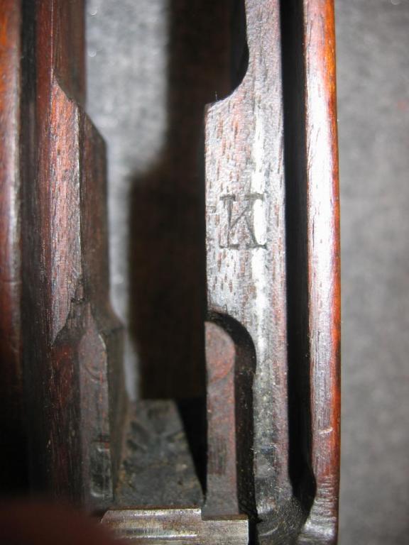

    I have a Winchester (SN 1,079,xxx) in WWII configuration in an oval oiler slot, high-wood stock that has only one marking that I know of.... a "K" stamped inside the stock between the mag well and the trigger well. This rifle has all Winchester parts, but there is no "W" anywhere on the stock. There is no indication of any marks in the sling slot, and the routing marks are still clear, so I don't think any were sanded off. I can't find any stock manufacturer with a "K" stamp. Can anyone shed some light on this? Another poster on another forum said the "K" looked like an inspector's stamp.

    Not all Winchester M1icon carbine stocks were marked in the slingwell. Occasionally, they did put different letters and numbers on the bridge behind the slide well and on the inner right side sort of even with the trigger housing opening. Remember also, that Winchester stocks have a pretty flat fore grip, angled cut in the slingwell and a thicker pistol grip area...plus some other things that I will be reminded of soon by other members!

    Keystone didn't make any stocks for carbines like this one but Winchester did use both numbers and letters in there stocks at different times. If Keystone ever did make stocks they would have been very late war/post war time frame.

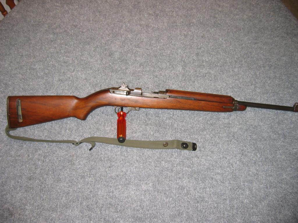

    I haven't received the rifle yet, but will submit more pics when I do. This rifle was in a family since the late 50's or possibly even earlier. The man selling it to me remembered shooting the rifle in '64 when he was 15, and it belonged to his father (who had been given it by the grandfather). The father or son did not know where the grandfather got it, but probably a vet bring back. Don't know if CMPicon was selling any WWII config rifles.

    Definitely a Winchester stock the. When you talked about where the K was, I was pretty sure what you had. Very nice looking early Winchester.

    Shows early features, high wood stock, with a later D clip sling. Very nice.
