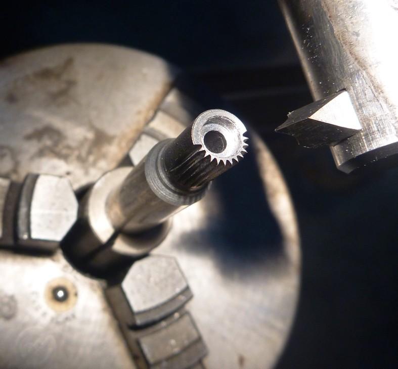

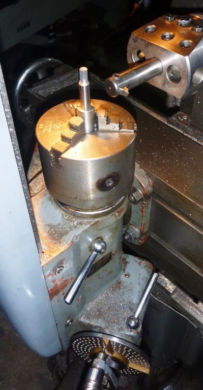

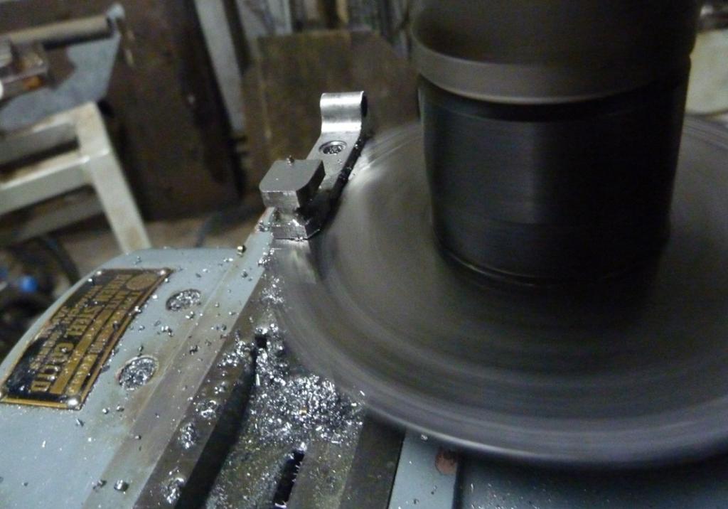

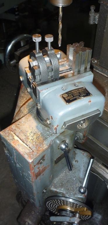

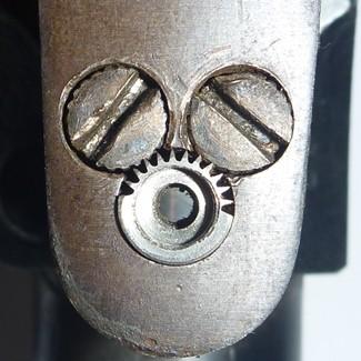

    The first of those parts I've resorted to making is the serrated "keeper Ferrule" (not sure of the official Ross Nomenclature) that engages the twin front action screws of the MkII ross (assumedly to prevent the screws loosening under recoil) . Had been told these tiny little pieces are virtually unobtainium, and can certainly imagine these'd be the first item lost once a rifle's been disassembled a number of times and in reality its probably of questionable necessity to the rifles machinations anyway.
    Mill set up in horizontal guise with the dividing head
    Close up of the machining details
    Note: The split magazine box and twin front action screws (and serrated keeper) necessitated by the arm of the "Harris" follower being on the centre line of the action.
    The "Keeper" installed in its pocket, engaging the other screw heads.
    The heads of these action screws are visibly mangled so if these can't be tidied up a bit, I may resort machining some replacements of these too. ("slippery slope"... I Know)
    Does anyone know the dimensions of the little bolt that holds the "keeper"?

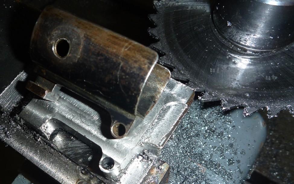

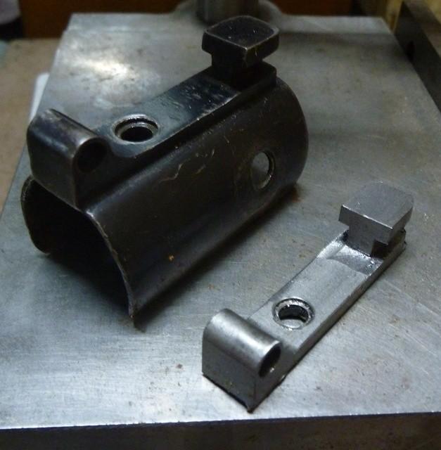

    Roughing out the profile & then parting
    Undercutting the lug
    Parting off with a slitting wheel
    The completed lug, now to work out just how i'll go about the forming & fabrication of the nosecap.

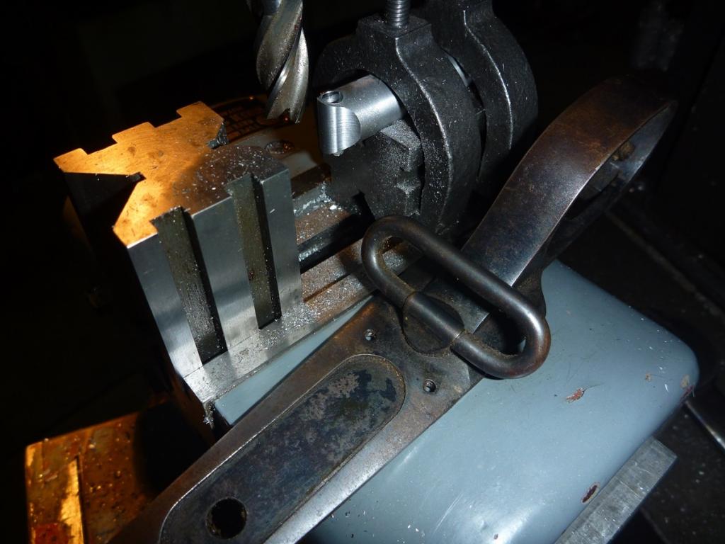

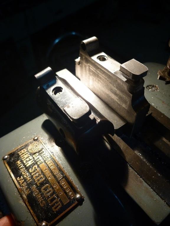

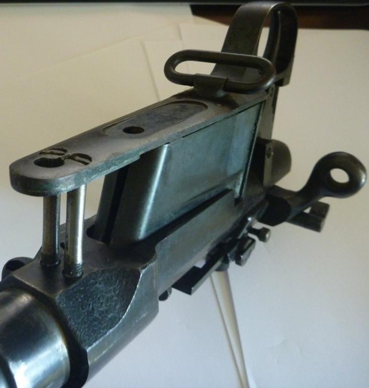

    Among the bits my rifle is missing is the rear sling swivel, so here's me working to rectify this:
    Using the dividing head to machine the wave shape on the rear sling swivel head. I used the existing target swivel attached floor plate as reference for the dimensions & styling etc

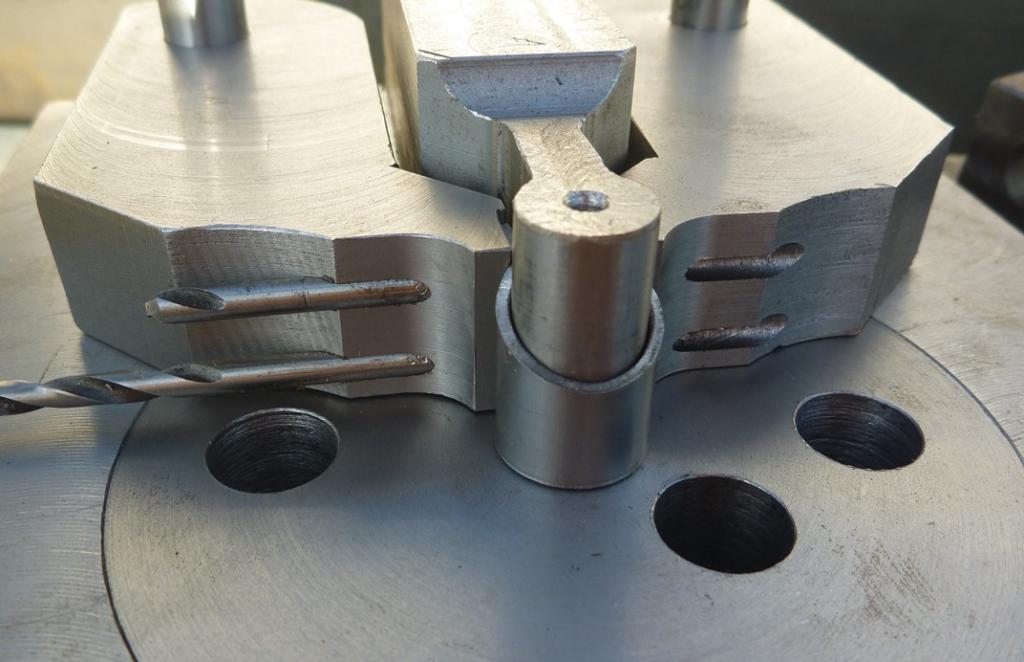

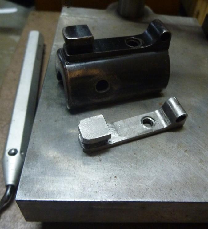

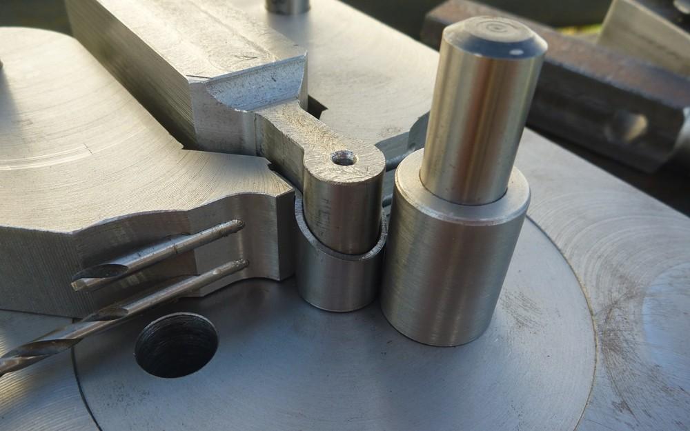

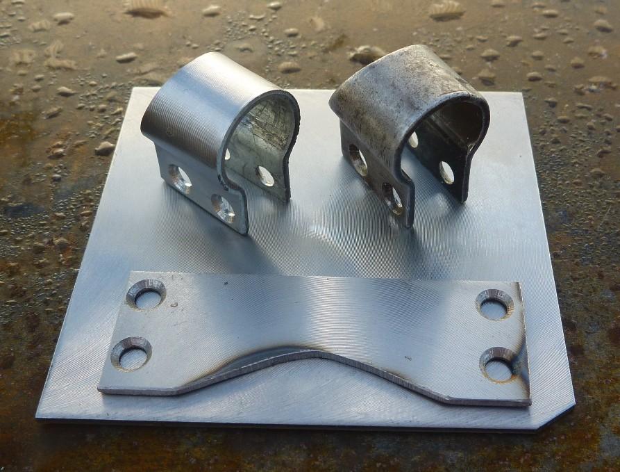

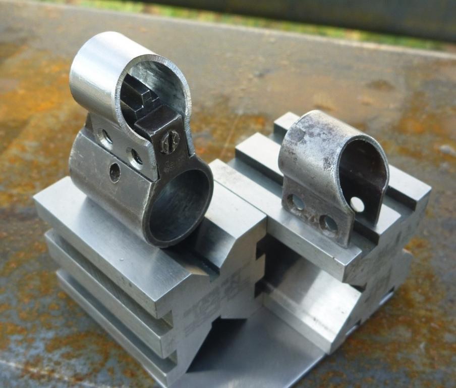

    Hi all, would like to thank everyone for their comments - just a quick update concerning my ross rifle project: Win88 (from the ShootingAustralia.net forums) magnificently offered to lend some of the missing componentry to me, for measurement/duplication purposes - so a massive thankyou goes out to him for his generosity and his patience whilst the reverse engineering/nutting out process crawls along.

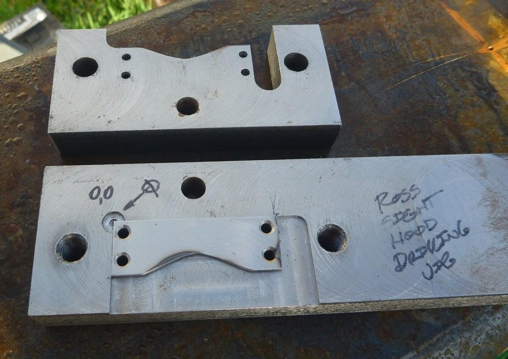

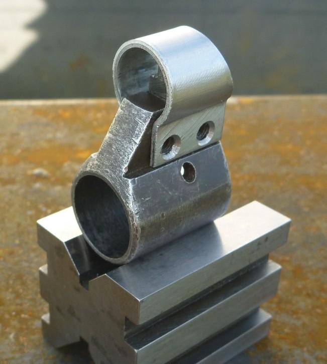

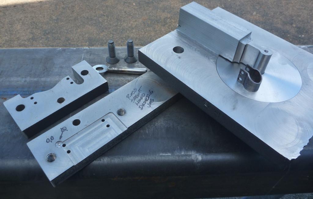

    The protective hood for the front sight was discarded from my rifle long ago and after some research it turns out they are right up there (along with MkII nosecaps) on the list of most requested ross rifle trinkets in the various milsurp classifieds. Those that have them aren't selling and Ross Rifle Co certainly isn't making any more so figured I could do something about it and help others out too.
    These are the jigs, I came up with to assist in the making of Ross sight hoods. Fortunately the hoods used on the MkII's & MkIII's are dimensionally the same, so the one set of tooling caters for both models.
    The number drills will be replaced with tool steel of the appropriate gauge, initially was just keen to see if the concept would even work.
    Have had to skim some material down to match the thickness of that originally used, otherwise the mean diameter would be wrong for the developed shape/layout.
    So long term will need to chase around and see what can be sourced - am hoping .0525" is a common gauge in some of the imperial speaking country's.
    Still need to de-burr a little and investigate blueing etc but think the result looks promising at this point.
