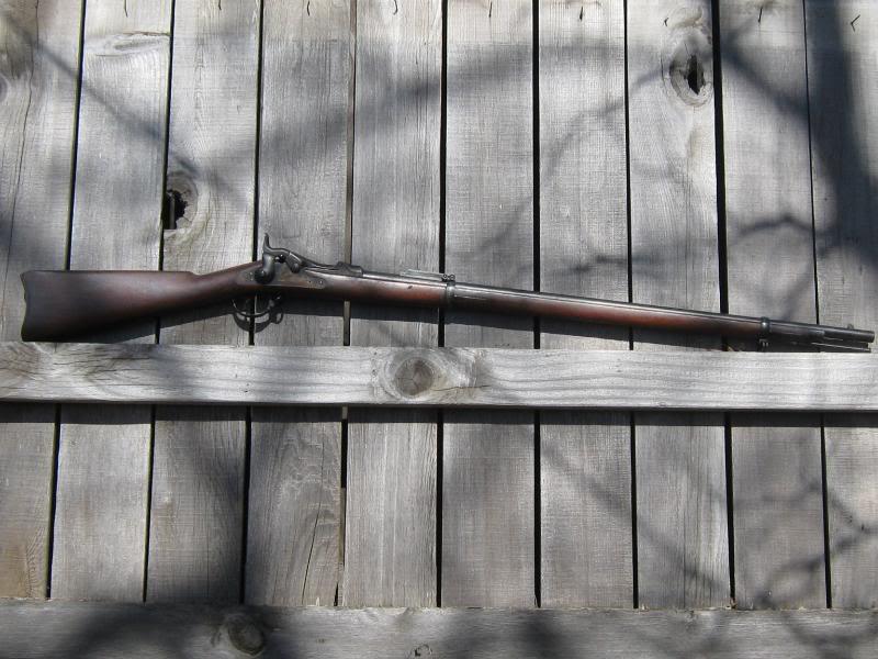

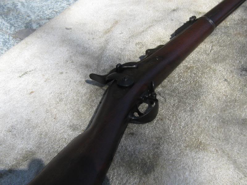

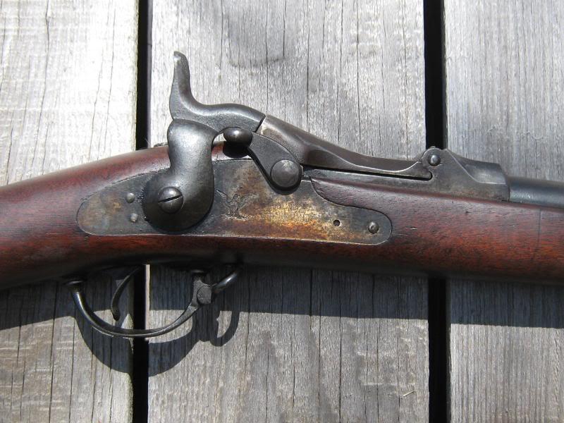

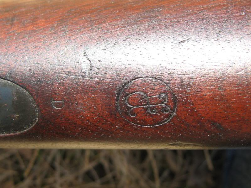

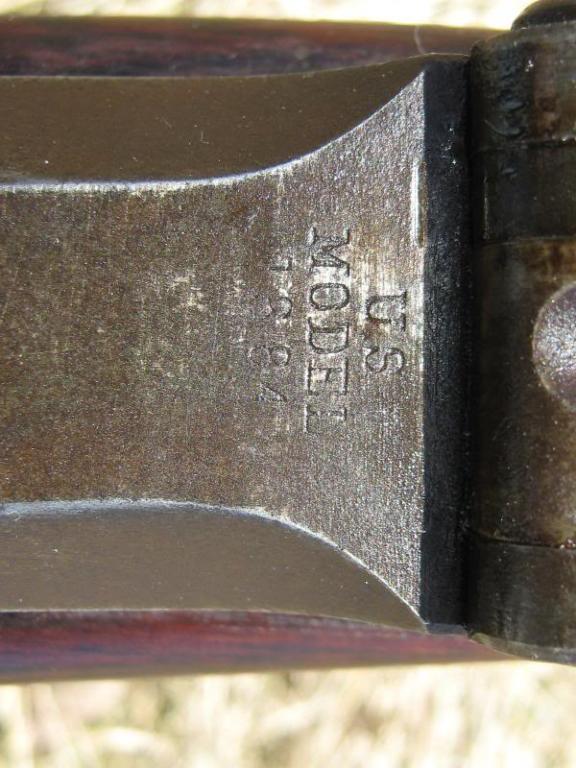

    I bought this last week on a live online auction for $400. It's my first Trapdoor and I plan on using it in our black powder matches. It seem to be in decent shape and the bore looks like a mirror so it should shoot nice. I think I got it for a reasonable price but I don't know anything about the Trapdoors yet(but I will). What do you guys think about the condition?

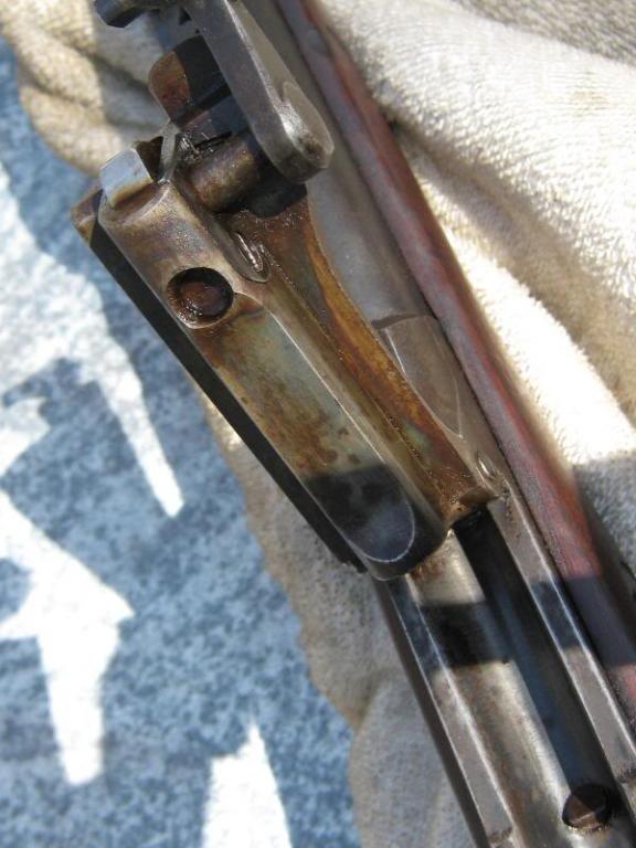

    The brown residue on the metal appears to be dried cosmolineicon, gun oil melts it off.

    If that rifle shoots OK, I think you got a real bargain. A competition-fit Trapdoor is worth four-figures over here.
    Patrick
    Sep 2008
    06-25-2023 @ 06:36 AM
    5,032
    05-03-2025
    10:04 AM

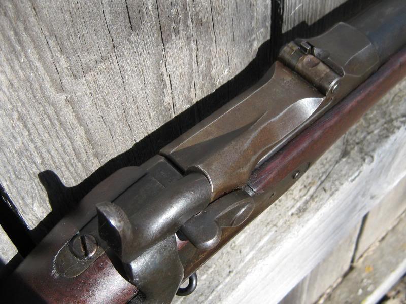

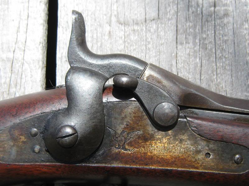

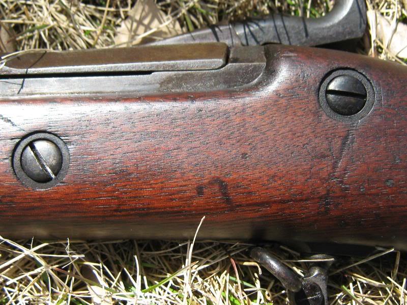

    P.S: A word of caution. There appears to be is some slight splintering of the stock wood behind the tang. This indicates that the tang is too tight, the system screws are not tight enough, or both - a condition that can cause the buttstock to split. The recess for the tang should be lengthened about 0.3-0.5 mm (15-20 thou), i.e. so that a piece of thick paper will slide in behind the end of the tang, giving enough clearance to prevent the system banging back against the end of the channel. I recommend that you correct this before using the rifle!
    Patrick

    Thanks a lot fellas, I appreciate the help!

    I have an 1884 Springfield also, which I shoot as often as I can. The chipping at the back of the tang appears to be more of an incorrect disassemly indicator (at some time in the past from the patina) to me. I'm far from an expert on trapdoor springfields, but I highly recommend the US Springfield Trapdoor Rifle Information Center webpage:The U.S. Springfield Trapdoor Rifle Information Center

    You did real good for $400. By all means, address the tang fitment problem before firing the rifle.
