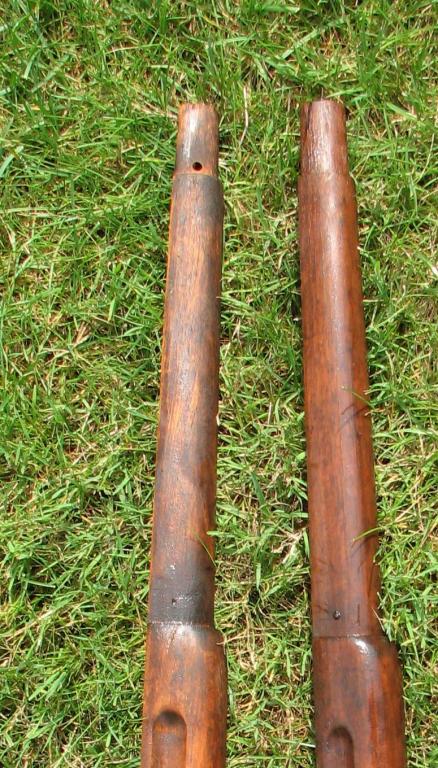

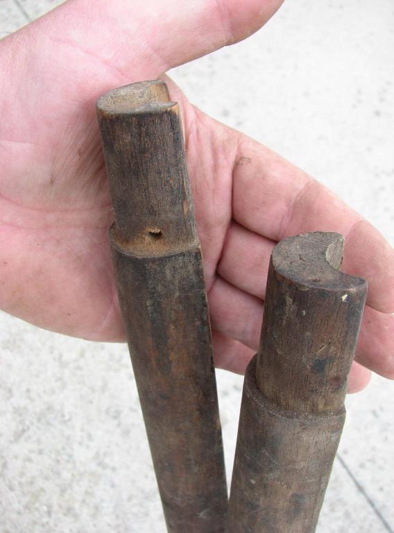

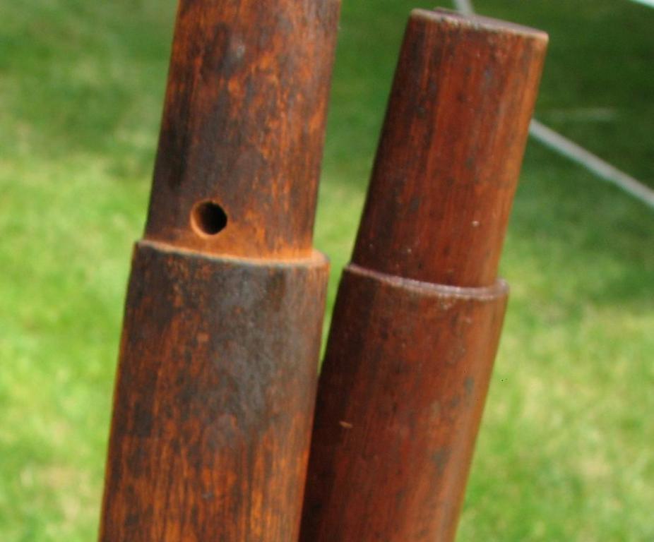

    While going through the Barn Wood so far I have found two 1917 Enfield stocks without a hole for the Bayonet Lug Band. Early?? Both are Remington. I have a four digit and maybe this belongs on it ? Rick Bicon

    unissued stock...

    Yep , spare stock . Hole was drilled when nose cap was fitted to rifle . Seen this on Springfield stocks , too.

    It has the eagles head and many other inspection marks. Was the Eagles Head only put on for the stock and not final proof? Rick Bicon

    someone has slobbered some sort of finish on the stock...eagles head marks are correct..

    An eagle's head can be a sub-inspector's mark or a final inspector's mark depending on placement , time period and type of weapon involved .
