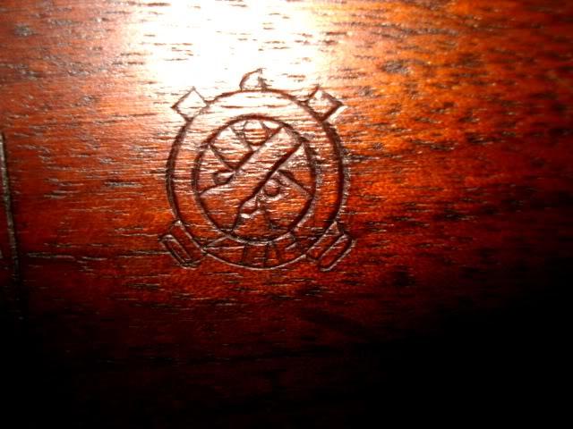

    I have a 3.8 mil IBM with "W-B" stamped in the sling well and hand guard. I can't find "W-B" stamp mentioned in Ruth, Riesch or Larson and don't yet have a copy of Harrison. The "W-B" stamp is very clear and deep on both the sling well and hand guard and there's no very light L preceding them, as in "LW-B." The stock appears to be a Winchester -- flat fore stock bottom, a Late Winchester Butt Plate and three holes in the stock underneath the plate. The Crossed Cannon cattouche on the RH side of the stock appears to be in the correct position for a 1944 Winchester 2nd Block Low Wood stock as shown in Larson pp. 358 and 363. The pistol grip is unmarked. The M1icon Carbine stock marking convention suggests Winchester supplied the stock to IBM for this 3.8 mil IBM. Was this documented anywhere?

    If Winchester had supplied IBM with stocks, it would have an IBM acceptance cartouche on it. The one shown is definitely not IBM and I have my doubts as whether it's even Winchester to be honest with you. I see some things that bother me, but will let others comment as I'm not sure about them.

    Stock does show some taper at the leading edge of the slingwell, often seen on many WRA stocks, but not all.
    The W concerns me, it's larger and a different style that's found on WRA stocks.
    Look closely at the picture of the Hand guard showing the large W-B, it shows that the ( - ) isn't squared off to the B. Almost as if it was added to look like it was part of a W-B stamp. In that same picture the W looks to have a different height, width and clearly different than the W stamped in the slingwell.
    Plus the spacing between the letters W-B is different on both the HG and slingwell.
    The CC? I'd need to see a few better Macro pictures to compare.
    Both the stock and HG have traits we can't see to determine if they were made by WRA.
    Pictures of the size and how aggressive the milling is on the inside bottom op slide channel of the stock and cut near the notch of the HG will help, like these:
    Also look for any numbers/letters stamped inside the trigger housing area of the stock, like this:
    Pictures needed of the stock would include:
    The flat bottom profile.
    The milling inside the stocks op slide channel.
    Overhead pictures of where the trigger housing sits in also need.
    A couple of views of the bottom of the stock at the escutcheon nut area.
    Keep in mind that a few makers used the 3 holes under the buttplate.
    M-U marked stocks are 3 hole and have a rather large M that could be thought of as a W.
    SC-B are 3 hole, plus have a large B.
    I don't recall the numbers of holes under the RMC stocks, but do know the RMC made for IBM stocks have a large B, randomly stamped.
    More pics needed, hope we can be of more help.

    Okay, very nice pictures BTW. I feel better about it being a Winchester stock most likely now. I see where that stock has had either a type II or III barrel band on it at some point. That alone would ruin it as being original to your IBM considering it has a type one barrel band on it. Another thing to consider is how long is the barrel channel on that stock? If it's the longer 4 plus inch one like it appears to be, that would be another strike against this being the original stock on your carbine. Winchester went to the loner channel stock after IBM had ceased production if I remember right. I am pretty sure the "B" has been added later to your stock. If it is a long channel Winchester stock, it's pretty rare, but ruined by someone most likely tinkering with it.
