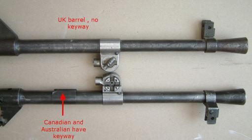

    I can say it's defo wasn't unfired. The Barrel is an Inglis replacement, the Daimler type has no key way for the locating peg found on an Inglis Mk2.
    Still, not to put a downer on things, it's still a nice condition gun and if you intend to fire it, your one up than me! I don't think you will ever regret it, except for maybe the cost of ammo. You can put your other guns to bed for good once you've shot a Bren.

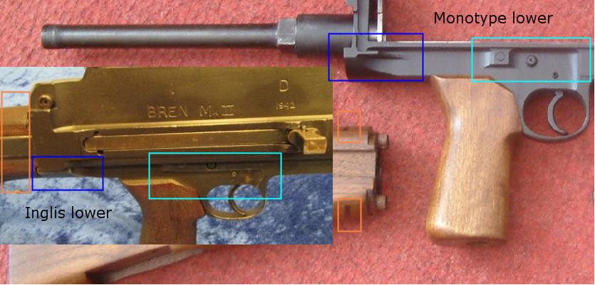

    As BP says regarding the barrel with the addition that the sliding butt group assembly is also Inglis (Canadianicon).

    Tom,hope the pics below help to point out the difference between Monotype and Inglis ?
    Barrels -
    Sliding butt group/Lower -
    Three pointers,machining to rear of the lower on Monotypes is MKI fashion with more material removed - marked in dark blue.
    Machining to area by sear pin is different - marked in light blue.
    UKicon F.Tibbenham butts have slips in the wrist of the butt,Inglis butts don't - marked in orange
    ATB KG
