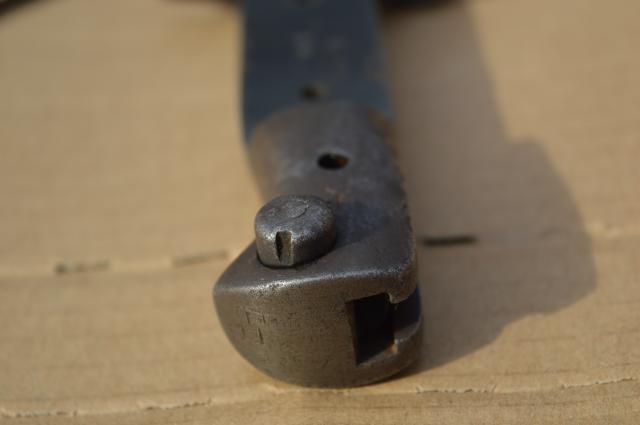

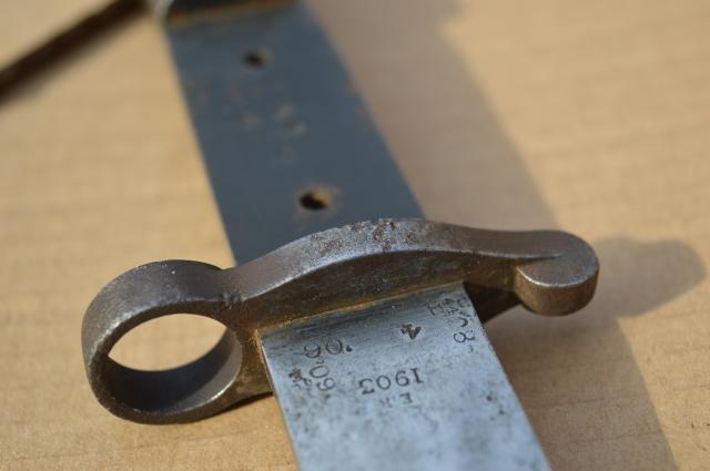

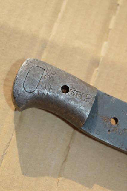

    The pics don't really show how bad the bayonet was but the bad parts were the pommel and cross guard with years of rust covered over by oil, polish, linseed oilicon ? Its whats now known in most descriptions regarding rust covered objects as "as a nice patina"

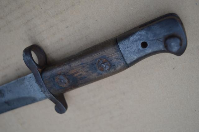

    So some pics below of what I started out with
    After removal of the grips, one was still good to go, the other well think the pic says it all, easy enough to make also new screws to be sought or made.

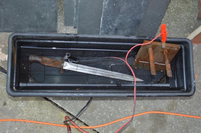

    For the electrolysis, Its very basic you need a car/motorcycle battery charger a plastic tub big enough for the item and also a sacrificial anode (scrap piece of steel) and washing powder.
    Plenty of clips of the process on youtube, WARNING you must do it outside as the only bad bit is the hydrogen gas that is given off.
    Fill the tub with water and about half a cup of washing powder, place anode in the tub it needs to be sticking out of the water to place the positive lead on to it.
    Place object (the bayonet) in water completely submerged with the negative lead attached, the object and anode need to be positioned so as not to touch each other.
    Pic below shows bayonet in the water along with anode and connected up the charger just a case of switching it on.
    I left it a few hours and had a quick a check, certainly working well and also cleaned off the anode, did this about 3 times during the process, total of about 14 hours ....
    Results were excellent, had to clean it off lightly with a wire brush but all the rust was gone some bad pitting were the grips would go so no dramas there, also a bit on the cross guard.
