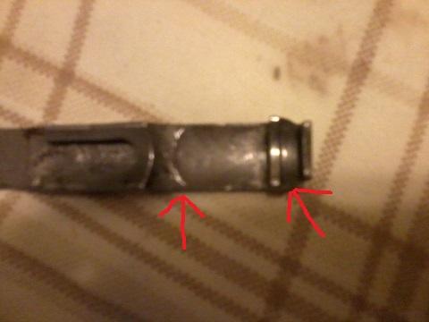

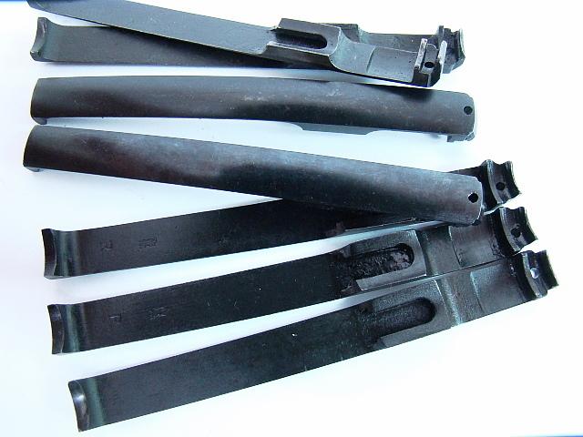

    I took another look over the bolt and thought maybe there could be an extractor issue? Well, I looked over the internet at pictures of 1917 extractors and found that mine didn't have a hole in the forward area where the claw is. Pictures to help describe below.
    This is what I believe the extractor should look like. Almost every picture I found were like these.
    And here's a picture of my extractor.
    There's no hole in mine. Also, the left red arrow shows that the cutout there is much more curved than those in the picture above this one.

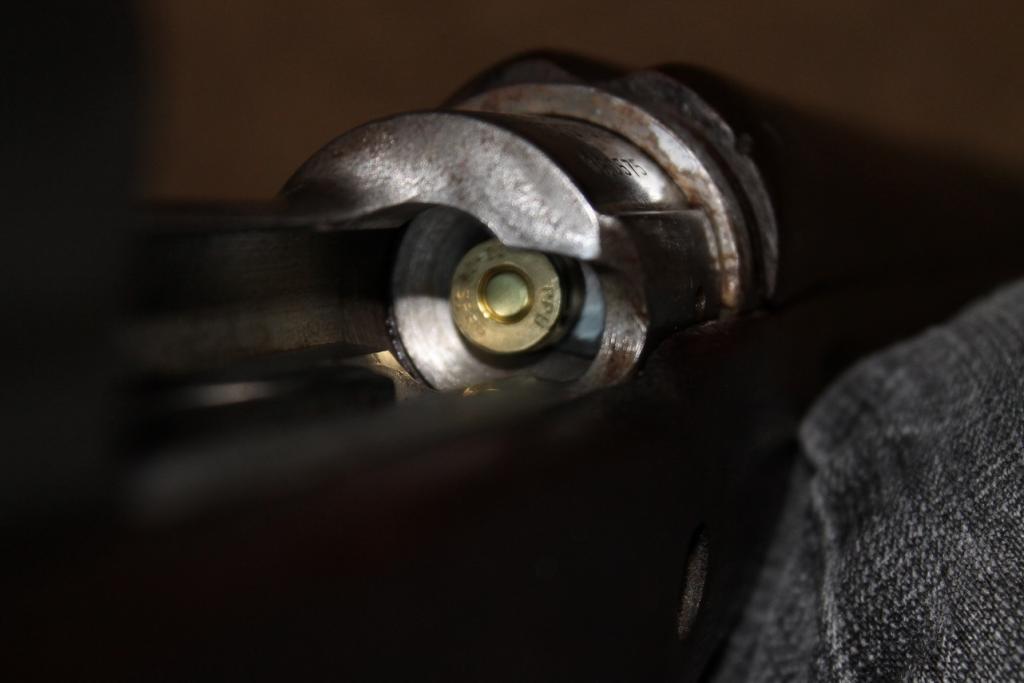

    I went ahead and ran to the local gun store and picked up a box of 30-06. I put a few in the magazine and tried to cycle them, but had the same problem. The bolt wont close. Here's a better quality picture of how they look and how far they stick out.
    On the bright side, factory cases are held on much tighter by the extractor, and don't fall off with the slightest wiggle the way the snap caps do.

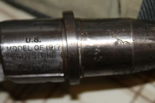

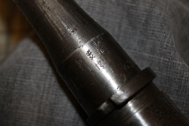

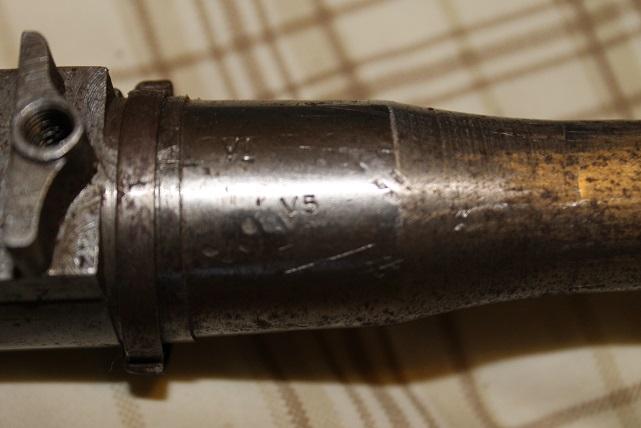

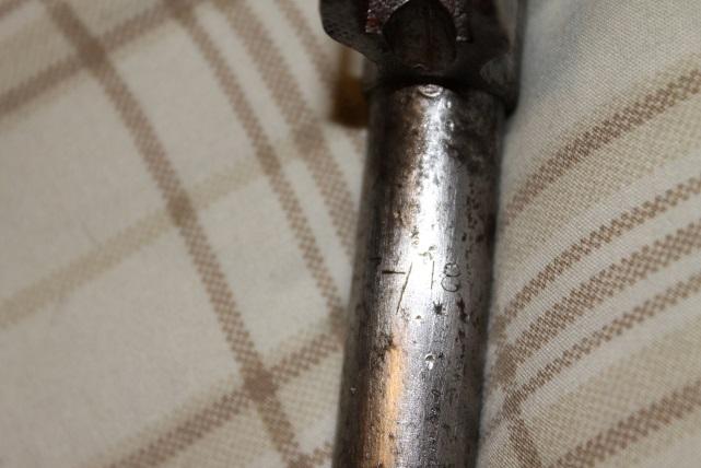

    Here's pictures of all the symbols on the barrel.
    Top view showing the model on the receiver + beginning of the barrel.
    All I can see is the flaming bomb mark, and the picture below this one shows an "X8" or "X6", with an eagle stamp to the left.
    Then on the opposite side (turning the barrel upside down), there's a "V5" stamp.
    The forward end of the barrel has the number 7 - 18.
    If I understand correctly, 7-18 means the date of manufacture, and the flaming bomb marks mean Eddystone. The "X8" and V5" marks have me clueless though. I cant find anything about them.

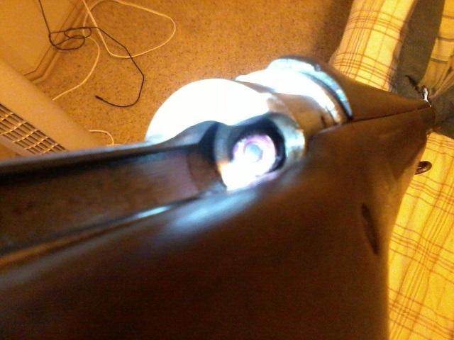

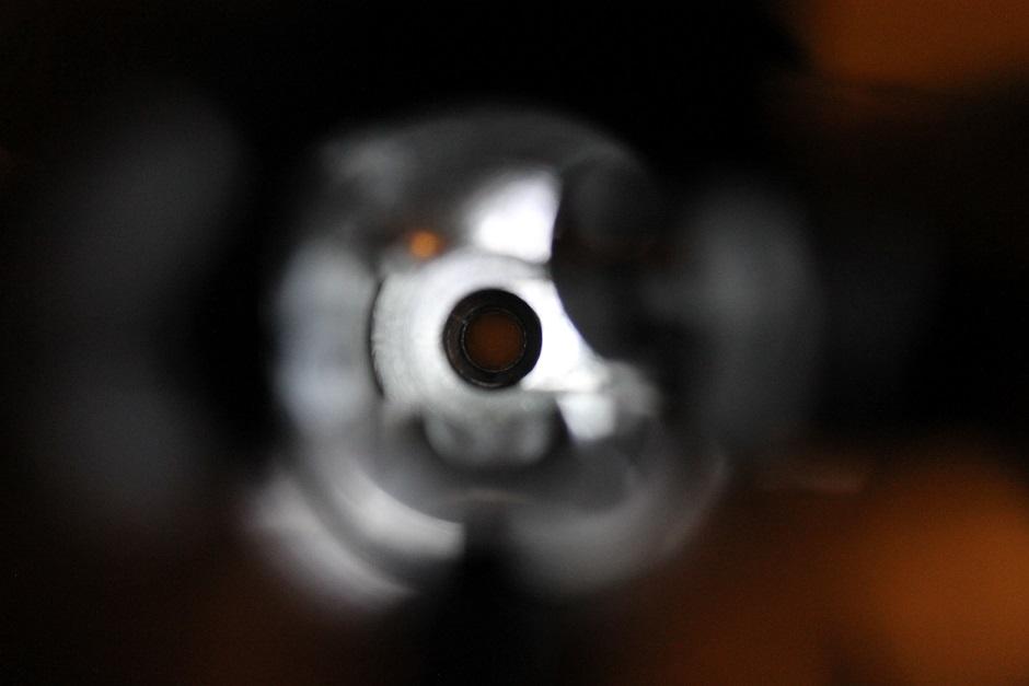

    It's possible. I don't really see anything abnormal in the chamber though. Im thinking about leaving a good amount of something like Break Free in the barrel overnight to see if it breaks up anything still left on the inside.
    I took a picture while looking down the barrel, if this helps in any way.
