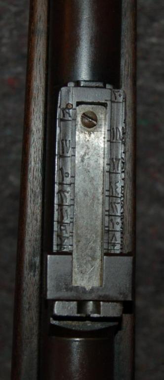

    Rifle arrived yesterday. It is an 1890 CE WG STEYR which saw Turkishicon service. All major parts match although two numbers were force matched at the arsenal. A lot of the smaller parts match also. The Bolt is a Turkish replacement and is not numbered. Shroud has a couple small dents in it. Rifle is relatively rust free but has two areas with deep pitting which is unusual as there is no pitting anywhere else. These are right by the GEW 88 stamp and in front of the sling hole on the magazine housing. The receiver was not blued by the Turks but has browned a bit. It is "S" stamped on the receiver. Enclosed are some of the barrel markings, etc. It looks like a Germanicon barrel so may not be a Turk replacement and thus may be the smaller diameter. Unless you guys can tell me otherwise, I'll have to slug it.
    Overall, I'm really pleased with it. The stock is dirty and dinged but not bad. The original German cartouches are there but have been sanded down so they are not clear. It is missing it's dust cover which I'd like to replace. It's been modified so it does not need the clips. Bore isn't new but it is rust free, fairly bright and with strong rifling. I'll get full photos posted soon.

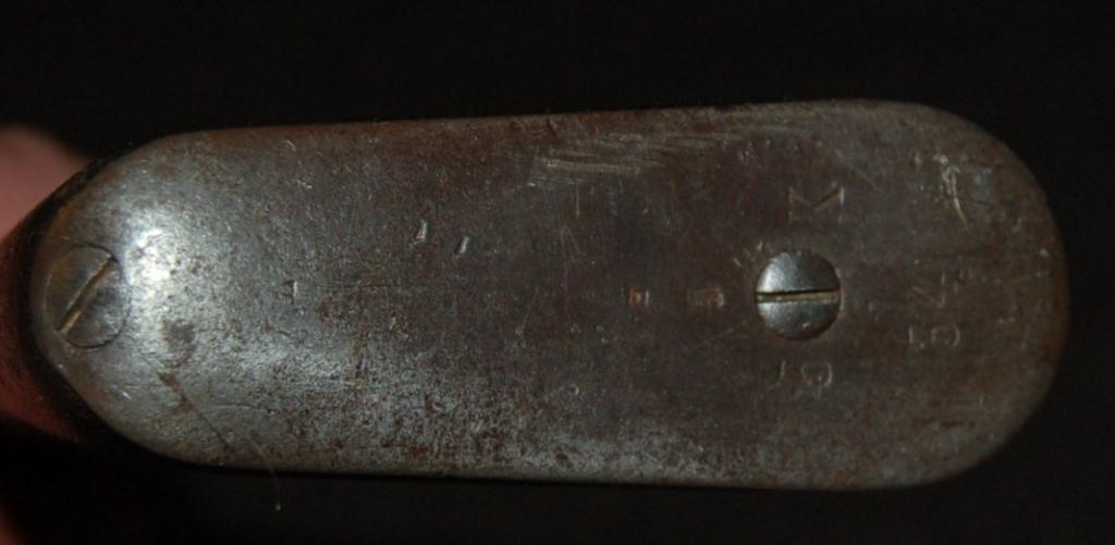

    From reading up on these, I got Scarlats's book, This rifle probably saw service with the Germanicon Army before being transferred to Turkey. After WWI, the Britishicon evidently took the bolts from the rifles to "demil" them and in the 1920's new bolts were ordered from Steyr to replace the originals thus the Turkishicon markings. Many were rebuilt at the same time and re-blued but this one seems to have escaped the re-bluing as the receiver and barrel are still in the white. The bolt handle appears to be a darker blue than the rest of the bolt but I can't tell if it only was blued or it simply "browned" more than the rest. Butt plate has lots of "information" on it but I can't interpret it. Unit's probably.
