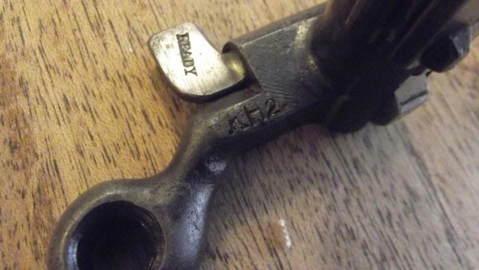

    A-H Mark On Ross Bolt
    Hi guys:
    So after stripping this old thing down to the eyeballs and scrubbing...and scrubbing...and scrubbing the bore, I've got one marking I can't identify, and that's an A H struck into the bolt handle. Any thoughts? As well, this rifle has the safety rivet, and I assume that means I can not remove the bolt head from the bolt, correct?
    Thanks.

    Is this a full military Mk III or a sporterized one? Where is the AH struck? Can you post a picture or two?
    Thx
    Ed

    Mk 111 with full length barrel and full metal bits minus front band and sight hood.

    Mine has OF9 in the same place. My rifle was one of those sent to India, though I don't know if that as anything to do with it. Tom

    My guess is that it is a steel batch number or heat treat lot number.
    Anybody got anything definitive?
