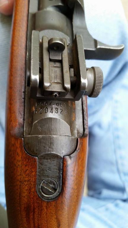

    well almost new,,I posted awhile back about a p14 and got such good advice I decided to try again.. I just fell into a pretty neat Rock-ola carbine,,its has a lot of rock-ola or R marked parts but I am curious about a couple things so I will give a quick rundown of what I have.
    Receiver ,barrel, round bolt , front sight, gas piston parts, are all Rock-Ola , all Trigger housing and group Rock-ola except hammer
    I did not take bolt apart so I do not know about internals,
    stock started life as a Winchester but someone got sand happy and removed all cartouches, still has Winchester recoil plate and butt plate
    handguard is a 4 rivet marked HI so not rockola
    barrel band is marked looks like MMD,,BUT could be WWO
    Hammer is in the white and marked LTP
    Slide is marked capitol U with top marks or omaga symbol cant tell which, has p in square and 7160091,, any idea who made ????
    REAR sight is where I have another question ?? I was told not original,,it is a type 2 milled with PI on the side,,Problem is,,the only steak marks on this sight to gun,,NO OLD ONES
    One of the experts at the GunBroker forums told me it was a '' mutilated gun'' AND HAD NO VALUE, I am disabled and pass time tinkering on guns so it makes me no difference ,,I still wish to know if the rear sight could be original, who made the slide, and barrel band

    Welcome to the forum! Great folks here, with lots of good info. Nice Carbine. Been mix-mastered a little bit, but the front band looks interesting. Is it a Type II, or a cut down type III? A type II band and Type II rear sight would be correct for your weapon, IIRC. Those would be original to the weapon.

    Whoever told you that your Rock-ola has no value is a moron who knows nothing or was hoping you'd possibly sell it to him for "no value." 6 million series Rock-ola carbines are very rare. It sounds like your is fairly original by what you're saying. The slide was made by Packard for Inland. Does the rear sight have an H in a shield on the right side? Rock-ola used Hemphill rear sights in their 6 million range. Your hammer could be original after all. LT-R or LTR would be Ludlow Telegraph for Rock-ola. Go back and look at the hammer again with a magnifying glass to see if it's a R and not a P. The barrel band could be a cut down type 3 with the letters you are describing. I think they may have been MMQ, or something close to that. I hope I helped you somewhat. Nice carbine!

    Barrel band is 100% type 2,,it has not been cut or had the bayo lug removed,,it never had one, The rear sight has me the most stumped,, the only marking on it is a PI stamped on the right side but if its been changed whomever did the work was great because it only has 1 stake mark and the lines match to a T, Its a good little gun,,I shot it today and it run like a dream, the guy I was with had a muzzle gauge and its a hair under a 1, I think I will hunt up a proper slide just to make me feel better and keep it at that,,maybe sometime in the future I may try to find correct stock , handguard and recoil plate, ,,I did go back and you are correct,,the hammer is marked LTR so the entire trigger group is correct,,,thanks

    that band is MMQ, and because it is marked MMQ it is, IMO, a cut down type 3 barrel band, not a type 2. When done well it is very difficult to tell.
    PI marked sight was produced by Packard Manufacturing Company.
