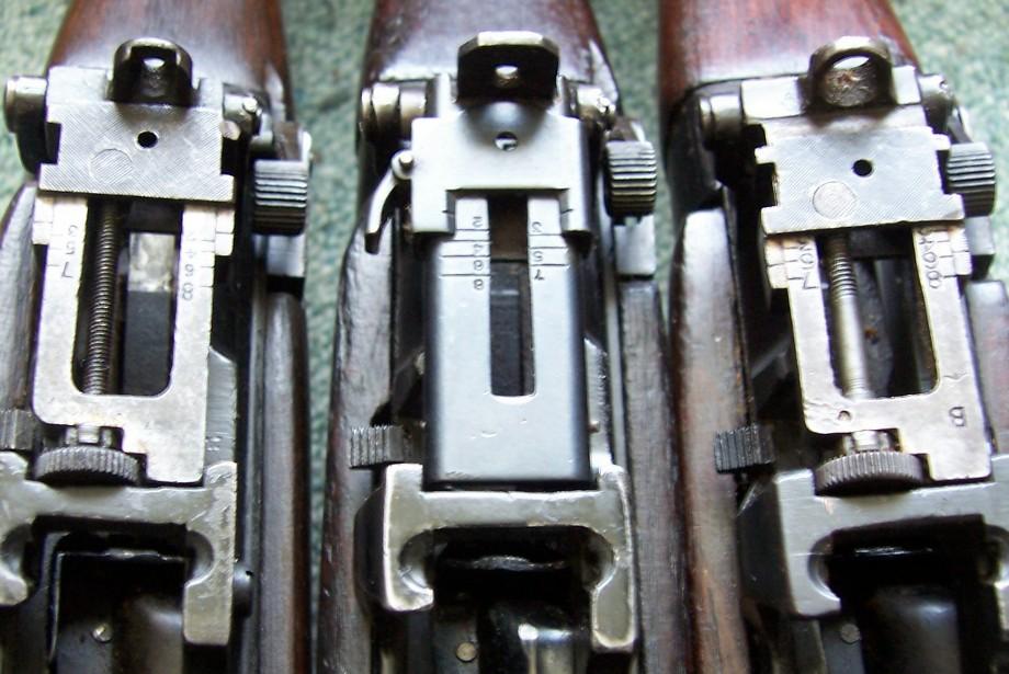

    There are at least 3 different rear sights for the No5
    The early milled type with a small aperture "battle sight"
    The later milled type with the large aperture "battle sight" the most common encountered type
    & the stamped type, there could be more??

    5thBatt, is it only the picture, or is there no checkering around the peep hole on your stamped No. 5 rear sight?
    Just checked, yes it has the checkering.
