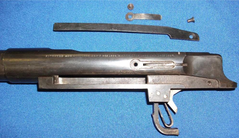

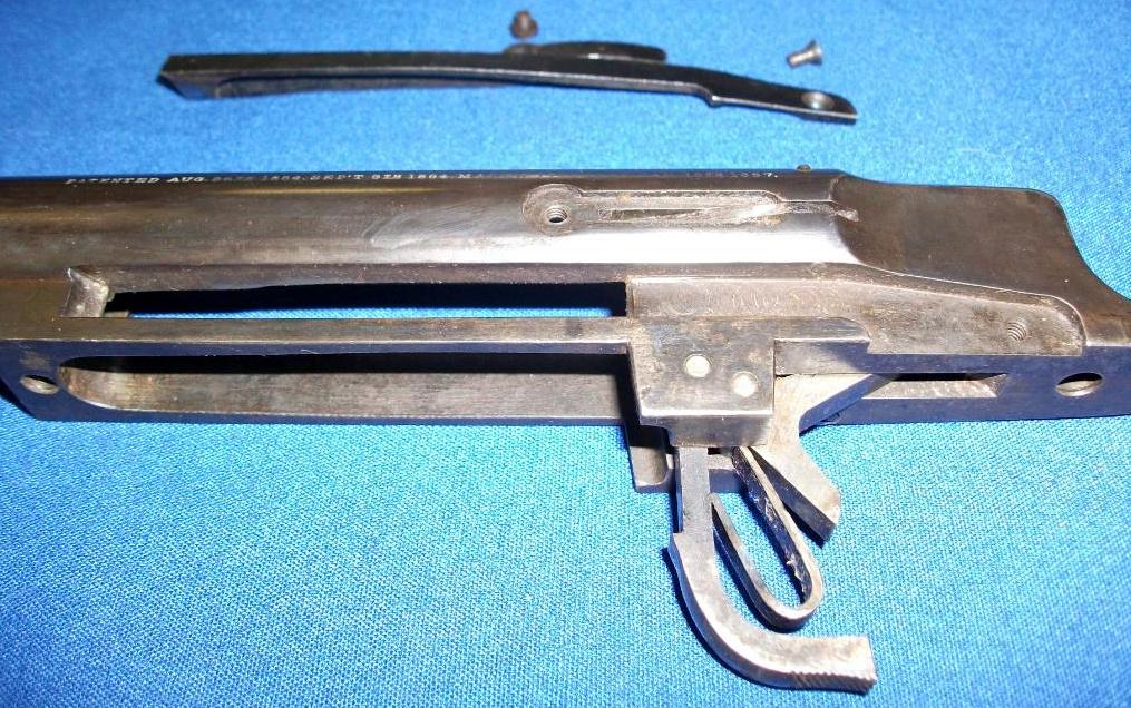

    #9a)
    #9b) Note the squared of locking surfaces. Easier to manufacture but the disadvantages are a less smooth operating cycle and less camming for operation in adverse conditions.
    #9c) Magazine well from the bottom with the single loading platform removed. The upper surfaces are not feed lips but rather magazine travel limiters. The protruding pin at the lower left is the pivot for the magazine catch (partially removed).
    #9d)
    #9e)
    #9f)
    #9g)
    #9h)
    #9i) Top view: Note that the spring loaded ejector in this action (different from the ones shown above with the blue background) has swung across the bolt path, but will move out of the way when the bolt is re-inserted. The other action's ejector won't pivot nearly this far!
    #9j&k) Detail shots of the ejector spring recess, and the ejector spring with screw. Another design shift from the earlier models and the Lee Enfield series.

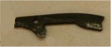

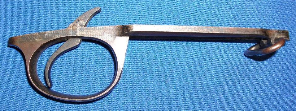

    #9r) Sear, sear/magazine catch spring, and magazine catch removed from the action. All the US Lees have single stage triggers; the Lee-Enfields received a two stage trigger during their development. Otherwise, this area is fairly consistant for all Lee turnbolts.
