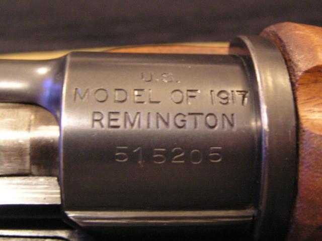

    Neeciemj, you have in your possession a very nice United Statesicon Magazine Rifle, Model of 1917.
    My M1917 is a fairly close to yours:
