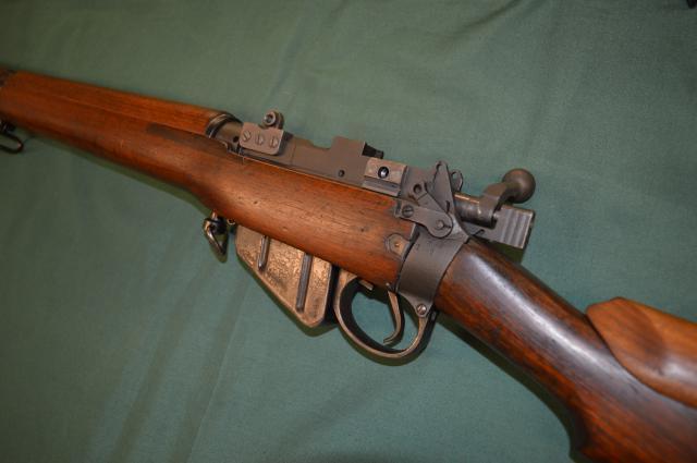

    Heres one I did earlier,

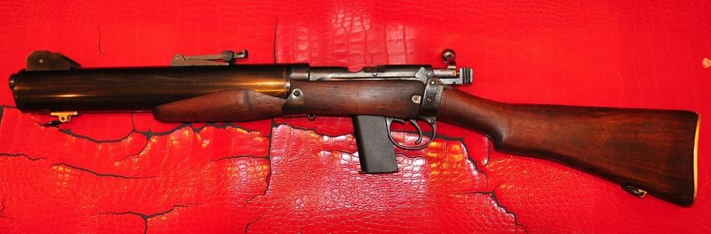

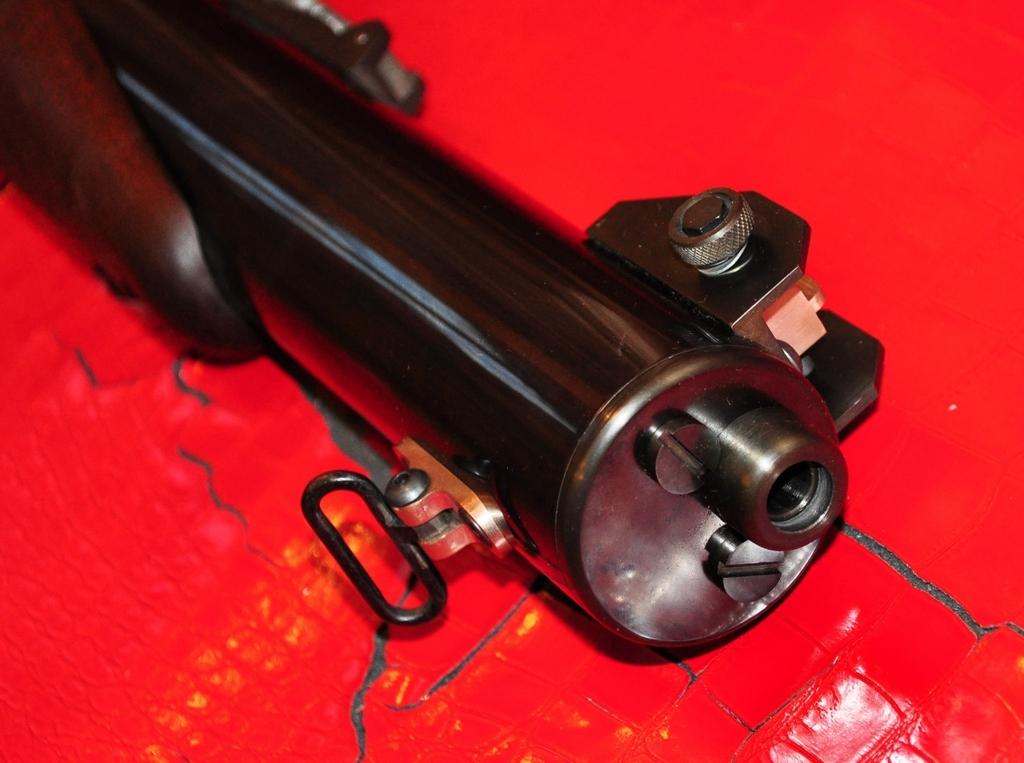

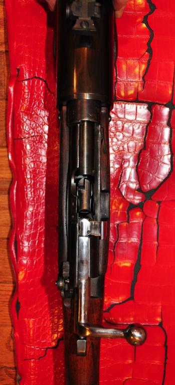

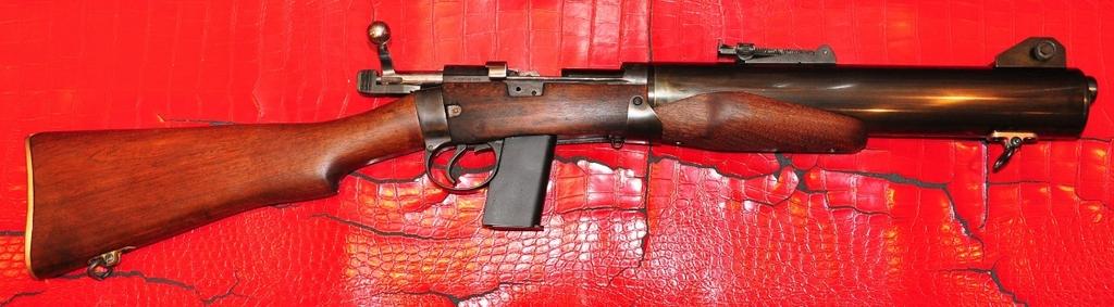

    I want to thank everyone who responded to my original question. Mr. Fjruple - thank you for your thorough response. I think I understand most of what you're trying to tell me. Mr. Robert Lynch - thank you again! Bigduke6 - you have the exact rifle that I want to build!
    I'm very new to the Lee-Enfields. I know very little about them. Here is my first project working on a No1 Mk3:
    There are several aspects of my rifle that are blatantly different from the real Delisle. Please understand this is my first attempt at a Delisle (and probably my last) and I'm happy with it so far. I had no idea how difficult this was going to be.
