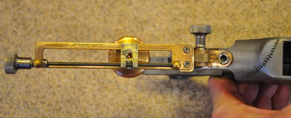

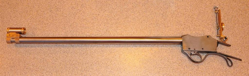

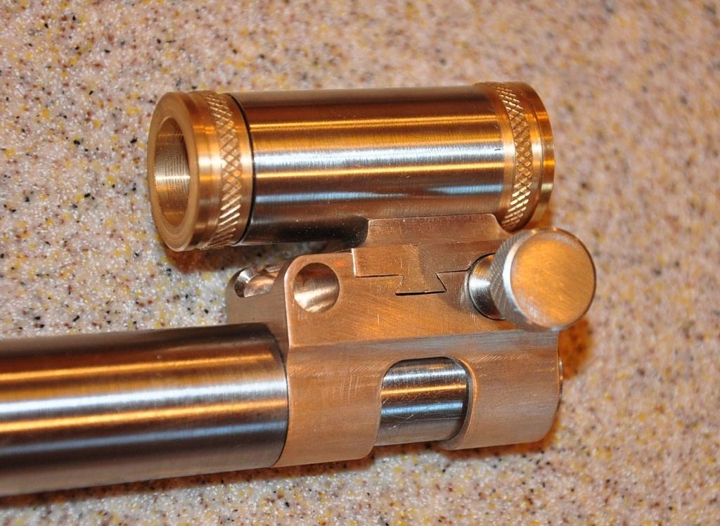

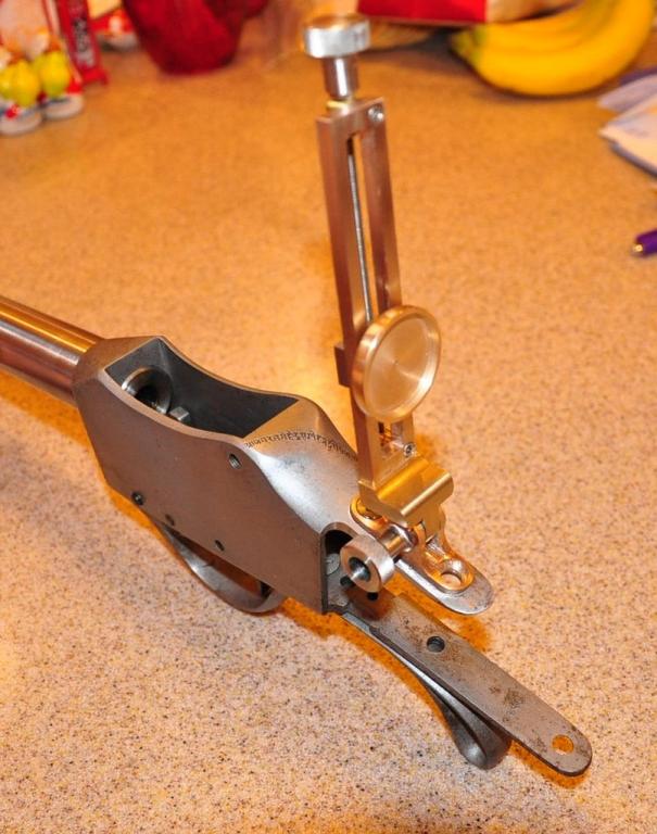

    I recently purchased a Gahendra barreled action and have started to use it as the basis for a new rifle. I purchased a Green Mountain barrel blank (in .44 magnum) and have threaded it and turned the outer diameter. I have also machined up a vernier tang sight as well as a windage adjustable front sight. I'm now getting ready to do the wood working. When I purchased the barreled action, it did not come with a stock. Does anyone have pictures showing the inletting on the read stock for the receiver tangs? Or does anyone have a beat up stock I can buy? I'll post some pictures of my rifle so far if I can figure out how to upload them.

    Yeah, I guess you're right. I've always wanted a big falling block rifle (like an 1874 or 1877 Sharps) with vernier tang sights, but I can't afford one. So I'm going to try and build one on the cheap with the Gahendra action. I chose 44 magnum because I'm only going to be using this for informal off-hand shooting at 100 yards. Plus I'm also weary about the quality of the 120+ year old steel in the receiver - I didn't want to pick a really powerful cartridge. I'll be thrilled if I can get the rifle to shoot 3 MOA or better. What caliber do you think I should have chambered this rifle for?

    The rear tangs on your receiver and like the original Winchester Hi Wall or somewhat like the Remington rolling block, easy job to lay-out. Locate the center line and you can even mill out most of the upper and lower tangs. You don't have to worry about a stock bolt used on other single shots. I done stocks for both the Hi Wall and Remington.
    I did build a small action Martini in 218 Bee years ago, always a problem with finding a high scope mount. Birdseye maple was most difficult to work with.
    You should be able to find an old stock to use as a startAttachment 66738Attachment 66739Attachment 66740Attachment 66741
