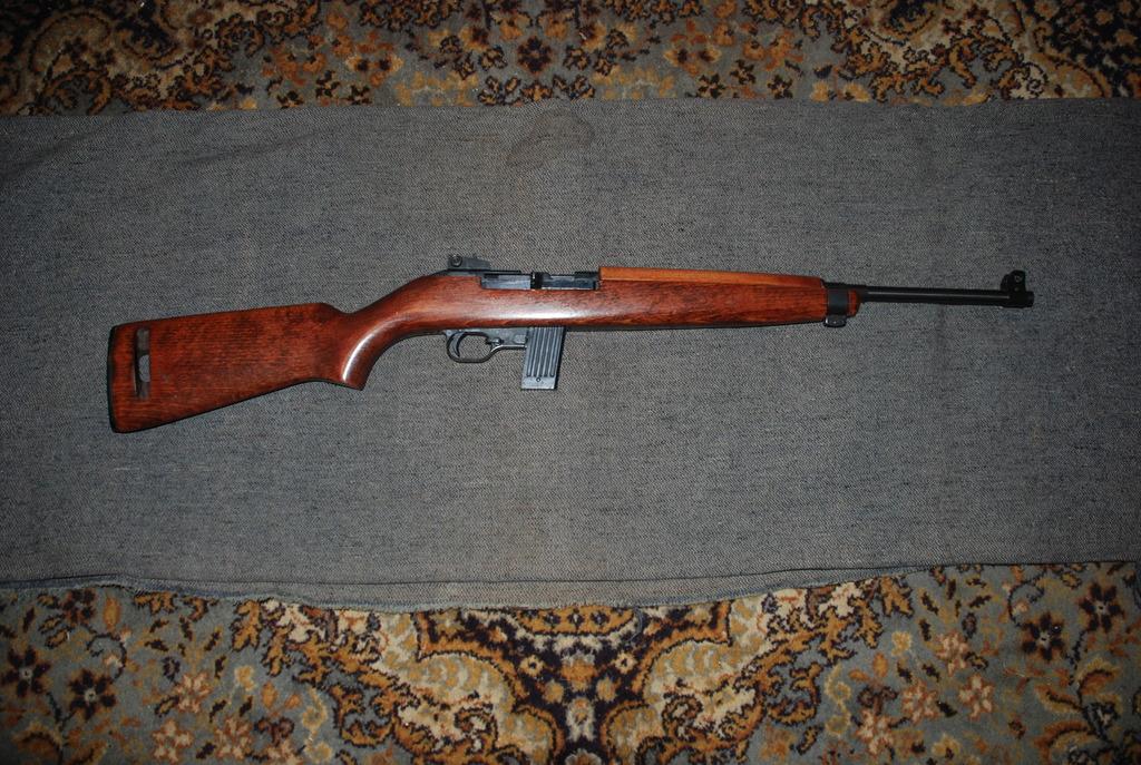

    Erma E M1 Carbine front sight
    I just purchased a 1968 vintage E M1icon on GunBroker and discover the front sight is missing. Too late to return the purchase. Can anyone direct me to a source for a front sight? The remainder of the carbine is in nice shape so I plan on keeping it.
    I'm looking on Ebay and GB, but none listed.
    LTC

    Cinders,
    Thanks, I have already sent them an e-mail a day ago. They show the sight as available, but who knows.

    Well, it took almost 3 months but I acquired a sight from Bob's and had it gunsmith installed. My first outing with it today proved the front sight blade is too high. It shot about 4 inches low at 50 feet. I will take a file with me on my next range visit and lower the sight blade as needed.
    Cycling is inconsistent. I will field strip the action and flush it out good with Gun Scrubber before the next trip to the range. If that doesn't work I'll have to try different brands of ammunition to see if that solves it.
    Wish me luck.
    LTC

    I returned to the range again today with file in hand. After about 1/2 hour and a bit of filing after every 5 rounds I had the EM-1 consistently hitting the X ring at 50' on a Bullseye 50' target (dime sized groups).
    I still need to work on cycling issues.
