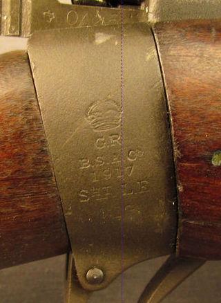

The wrist of the receiver shows that it started life as a No. 1 Mk III* manufactured by B.S.A. in 1917. The left side of the buttstock describes the rifle as a Lithgow No. 1 Mk III dated 1941. The buttstock shows the rifle was converted at Lithgow to a No. 2 Mk IV* in 3/49. The conversion barrel has Lithgow proof marks and is dated 2/49.

Receiver: D with Broad Arrow inside, Crown over Crossed Flags over P, Crown over 16 over 13, 3 over 87934, G over 52395, Broad Arrow, AUSTRALIA, Crown over M5 over stylized B, stylized B, Crown over G.R. over B.S.A. Co over 1917 over SHT LE over III* (on wrist)
