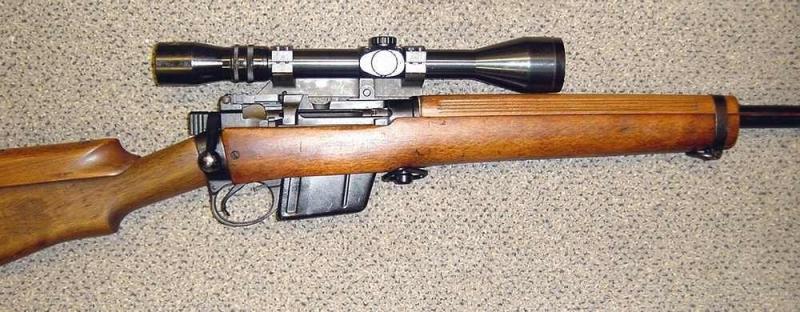

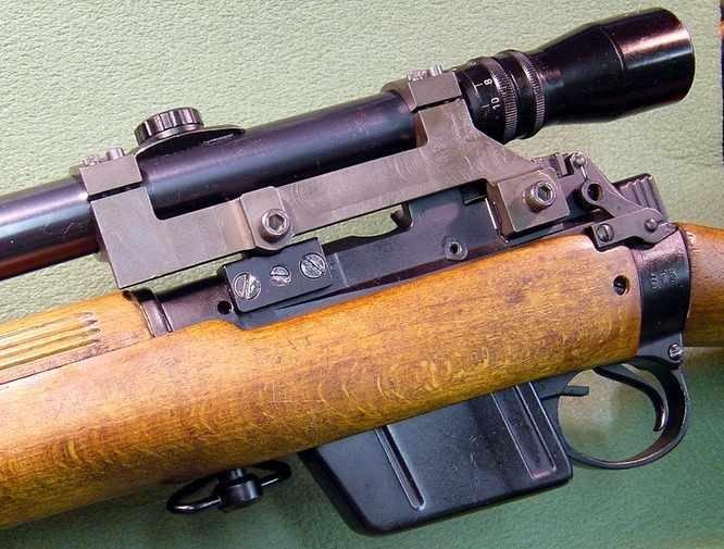

    L42A1 with Leatherwood ART 2
    Can anybody shed any light on this combination? How many were fitted or dates when they were either trialled or used?[70409[/ATTACH][/ATTACH]

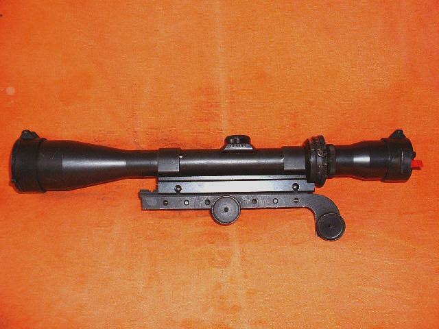

    These never got out past the first hurdle for several reasons. Compared with the No32 and the rest of tghe worlds sniper telescopes, just how complicated does a sniper telescope have to be. Not waterproof enough for the UKicon climate either
    Added later...... I recall that there was a problem with the clicker mechanism too. There wasn't a positive 'click' method or if there was, it didn't equate to anything. I have/had the brief trial notes on microfische. Difficult to read/very grainy.

    Saw such an ART set up photographed in Jane's Infantry Weapons in several late 1970s editions. (Under the optics section.) Was thinking it was the earlier AR TEL version, but it's been a while.

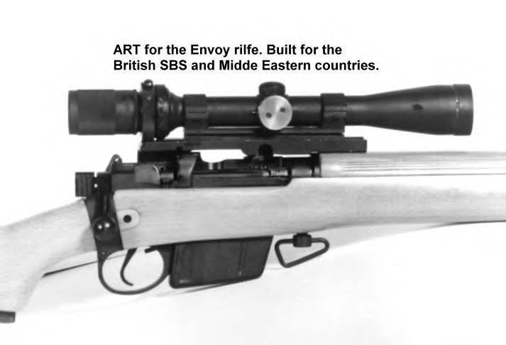

    There are some photos knocking around of ARTs mounted on converted Envoys - plus suppressor - and being apparently tried out by RM.
    Edit; I've got downloads of the photos, but I don't know who to attribute them to. Anyone here claim them?
    I'd found these interesting, as an Envoy converted to L42 format passed through my hands at one stage (the Pecar was my temporary addition):
