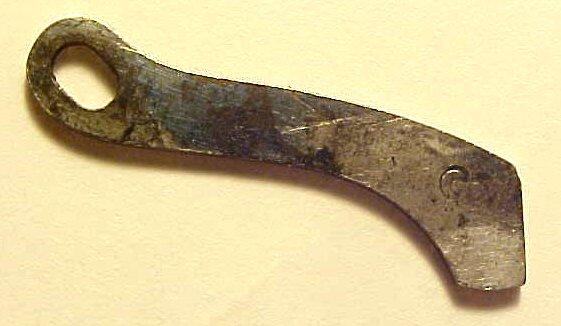

    Check two things:
    !. Ejector arm installed properly (not backward).
    2. Ejector box CLEAN and lightly lubed.
    Backward ejector and dirty ejector box can cause lazy or erratic ejection.
    Endless apologies if you already knew all this. Best wishes. Dave

    Quote Originally Posted by MasterChief View Post
    Check two things:
    https://www.milsurps.com/images/impo...4/xlarge-1.jpg
    No apologies needed. I'll check it out compared to the flawless Mauser when I go get it.
