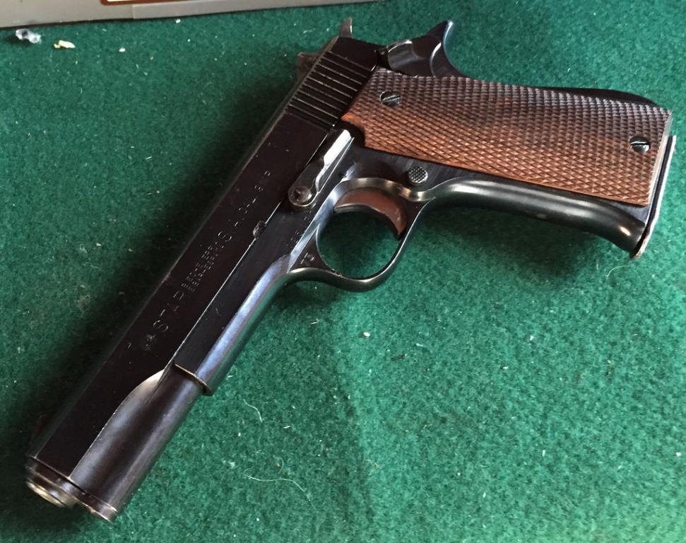

    Grabbed this at the fun show yesterday. These are of impressive quality and if you can find one grab it. For the going price they're giving them away. Feels very good in hand, can't wait to get to the range.
    This one is well wore but tight, just how I like 'em. Bore is fine. Thanks for looking....

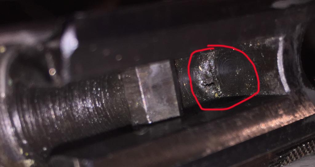

    Just make sure there is no hole in the frame under where the stop/guide for the recoil spring sits under the barrel.
    When I got the gun I first thought it was dirt, it was only after digging at following shooting about 150 rounds through did I figure out what the real issue was. I ordered from AIM and took a real beating on sending it back even though they were great about it; $50 return shipping on a $260 gun, ouch! Kind of soured me on them despite being a decent shooter so I just bought a CZ75B to replace it rather than try to deal with another; I had failures to extract I strongly suspect were related to this issue but was not about to find out while I could still return it. Looking at it with a smith best guess was an issue with the heat treating on that lot (a 1973 example) or perhaps when the barrel was replaced (did not have an S/N which suggests replacement) the edge wasn't fit well and on recoil it was somehow catching there and beat a hole in it. If you see how it fits together you'll get an idea of where I'm talking about. Notably the plastic grips didn't fit correctly either, the screw holes were off center. Frame and slide matched but I think I got a Monday gun, or it had been through some abuse prior to being sold off as surplus.

    Well, thanks to cipherK98 post I took a harder look and guess what I found?
    Yup, a hole.
    Attachment 71571
    It's not a crack but a hole. It's that there's no material left after the machining or I should say very little, maybe 15 thou. The hole goes into the slot cut for the trigger. With the trigger in, the top of it is right there. No way this area was designed to handle any stress. Attachment 71572
    I literally punched through and opened the hole with a toothpick!!
    Cleaned it up with a needle file and rounded the edges just because. Attachment 71573
    I'll keep an eye on it but I think it'll make a good oiling point.
    If you have a hole on your frame don't mess with it unless your willing to completely strip your pistol. The trigger is first in, last out. The reason is anything going "down" into the hole will effect the trigger pull.
    Thanks for raising this issue cipher98. Something to look out for.
