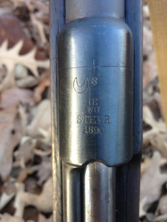

    Have opportunity to purchase this Turk Gew 88 from a friend.
    Steyr 1890
    Other than barrel matching receiver, gun is a mix-master.
    Bolt is self matching Turk
    Metal other than bolt is sort of a rough blue. Almost like Parkerizing.
    Bore is bright with good rifling
    Side of sight base in marked "7,92"
    Stock appears to have been shellaced. Was this ever done by Turks as part of rebuild.
    Front site has been replaced. Are these readily available?
    Overall a decent gun for being 126 years old.
    Curious on what members think a fair value for this is?

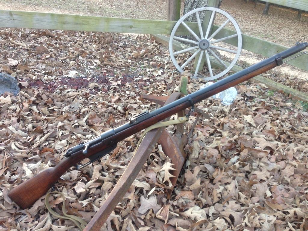

    Paid $125 for mine 3 years ago at a yard sale. Was still full of cosmolineicon. Excellent bore. Seller didn't know caliber or anything about it. Was shocked how good the bore looked once I cleaned it. Only issue was the headspace was way out with the replacement Czechicon bolt-but pretty simple to set the barrel back and re-chamber with the sights on the barrel shroud.
