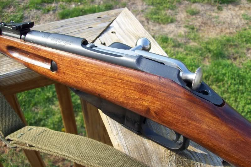

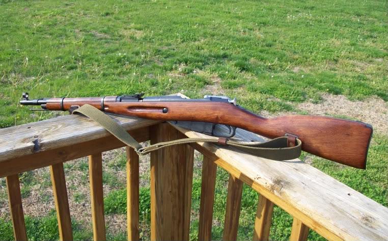

    Well although not technically correct I think my M44 turn out well,I hated the old shellac cracking and scratching so easily so I removed it all with denatured alcohol down to the original wood. There sure were a lot more marking on the wood than I has seen with the old finish on it.
    Needless to say my budges is pretty tight so I couldn't spend a whole lot of money on material but I want to make it look as close to original as possible. I hand rubbed in two coats of Min-Wax Red Mahogany stain and let it dry fora couple days then I applied four coats of clear fast drying poly over several days and buffed with 0000 steel wool in between coats.
    While I was at it I floated the barrel and shimmed the front and rear lug with a cork washer as well as shimmed the front part of the barrel where it meets the wood. The rifle shot decent before but it shoots great now especially with my cast bullet loads. Not to bad for a $75 rifle and $10 worth of refinishing supplies.
    Darkwolfe's Avatar
    May 2011
    08-03-2011 @ 10:01 PM
    KCMO
    46
    05-10-2025
    08:25 PM
    That's a very nice finish on that M44. I've been debating about stripping off the damaged finish from my '42 Ishevsk 91/30. Its number are all mixed up with strikeouts and electro-pencil crap so I wouldn't be losing any real history on it. Might well do the job.
