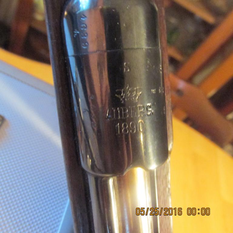

    Picked this GEW88 rifle upover weekend?
    Picked this GEWicon 88 rifle up over the weekend. Not sure what calibre it is wood is in nice shape.finish is real deep blue glossy, marked 1890 AIBERG NOT SURE IF THAT IS RIGHT.

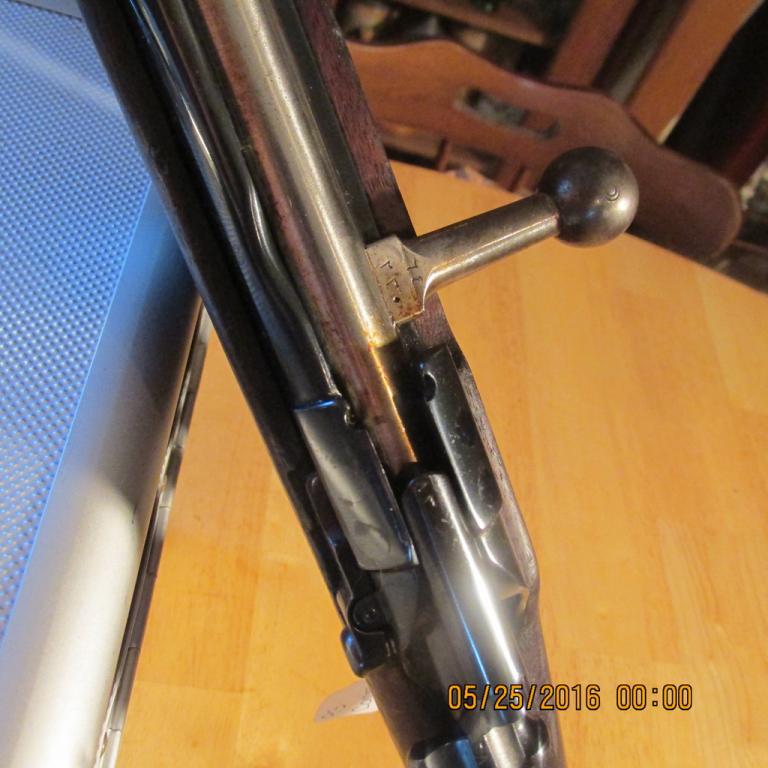

    Arabic on the bolt handle?

    It's a Turk replacement bolt. Probably Turkishicon numbers on the rear sight also. Should be 8mm, has the S marking but Turk bores vary in size so should be checked before you shoot it. Glossy finish probably not original.

    I thought the receivers where in the white(not blued) on these??
    I have an 1891 AMBERG 88

    Quote Originally Posted by AZPhil View Post
    Semper Fi
    Phil
    They were originally, however I believe they were blued when converted to the 88/05 standard (and if not then when the Turkishicon received them, I haven't seen any non-Turkish 88/05s to compare... yet)
    Legacy Member bob q's Avatar
    Sep 2014
    05-01-2025 @ 07:04 PM
    north texas
    495
    05-06-2025
    01:26 PM
    They were not blued when the 05 conversion was done . That is not Turk bluing as it is way to shiny .
    Today @ 09:08 AM
    31,021
    05-06-2025
    11:26 AM
    No, that's a commercial re-blue. Polish and blue...
