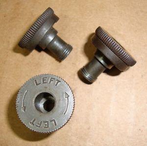

    Generally Winchester has an open arrow head and Springfield a closed arrow head. Very early Springfield used an open arrow head I believe.
    Winchester
    Springfield
    Bill Hollinger
    Legacy Member RCS's Avatar
    Yesterday @ 07:16 PM
    4,467
    Robert Seccombe
    05-05-2025
    04:52 AM
    rear sights
    Attachment 74332Attachment 74333Attachment 74334
    left: very early Winchester and Springfield (from WRA 100931)
    middle: Winchester
    far right: very early Springfield
    late knurled knobs with open arrows should be Winchester
