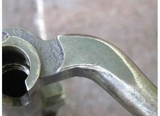

    One other thing, be sure to examine the REAR of the bolt handle root.
    Here is one with a "S" marked there. This bolt is believed to be original to RIA 1767.
    DW
