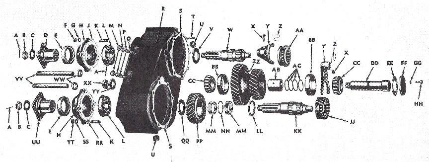

    Hello,
    My 1953 M37 needs a replacement transfercase drain plug.
    The crankcase plug is a strange torxlike plug so I'm assuming that the transfercase is the same type.
    Has anyone ever seen one of these or know where to get them?
    Any help would be appreciated.

    Do you have the old drain plug or is it missing? In the past when I have needed an unusual drain or filler plug for an old or obsolete vehicle I have made them myself. This is a much easier exercise if you have the old plug to measure and examine the thread type etc.

    Most drain plugs in axle and transfers case use are a square drive 3/8" or 1/2" socket with National Pipe thread and should be easy to source. Using the links Jim provided, I pulled the following part number from the diagram:
    U 7374954 Plug, Pipe, 3/4 (2 Needed)
    If that information is correct, it should be an easy fix, a serviceable (but not period correct) plug could nearly be sourced from your local Home Deport in the plumbing aisle.
    - Darren
