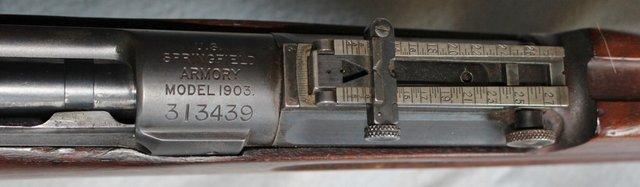

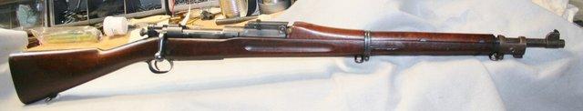

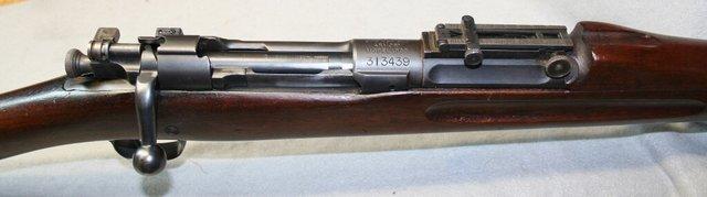

    I found this rifle on Gunbroker and paid $885. It was SA 313439. It had, as you can see in the pictures, been worked over and had a number of replacement parts, but hadn't been touched since the pre-WWI period.
    1. The barrel is SA 6-15

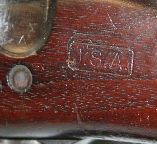

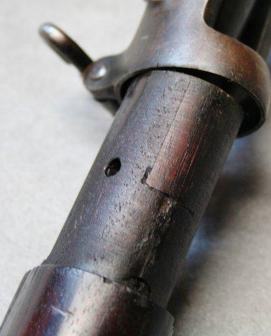

    2. The stock is a reworked Rod Bayonet that was reworked to later standards - it has the "dog-leg"-type top edge. The old script inspection stamp (I think KC) is overstamped with a crisp "JSA stamp. The plug is evident in the foretip with the small 1/8" "S" stamp; the stock has the rear stock bolt only.
    3. It has the later handguard with sighting groove
    4. A dished windage knob with no groove along the edge;
    5. The rifle either retains it's bluing or was reblued
    6. The bolt is an S31 from ca. 1908.
    Although technically a rebuild, like the 1906-1910 rifles, a very interesting one.
