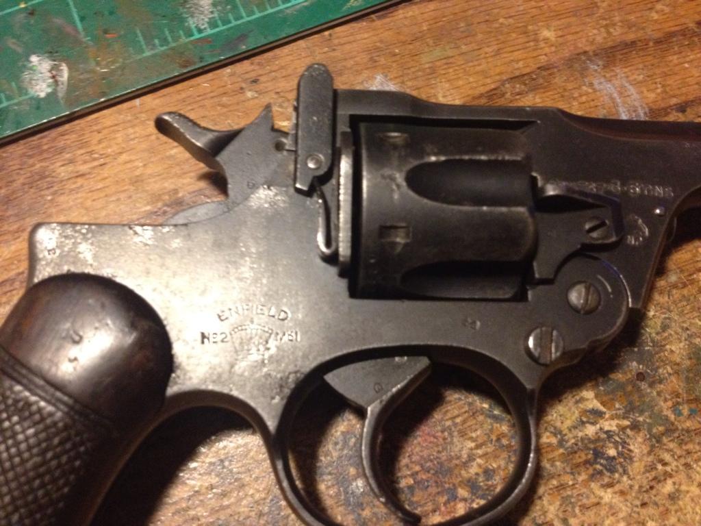

    Enfield No.2 Mk.I Firing Pin
    Hello all, I am now the proud owner of an Enfield No.2 from an auction site but I need something for it. I need to locate a replacement firing pin for this revolver and as yet, I have had no luck. Am I correct in understanding the Webley in 38 is in no way interchangeable with the Enfield service revolver? Any leads or suggestions are greatly appreciated!

    Totally non interchangeable. PM me with address and I'll send you a new firing pin and rivet

    I know it's been a while, but here is the revolver, WITH the new firing pin courtesy of Mr. Laidlericon. Again a huge thanks from you, it shot marvelously. I know its not the belle of the ball but she's still pretty cool and very pleasing and a steal for less than $200. Definitely a keeper!
