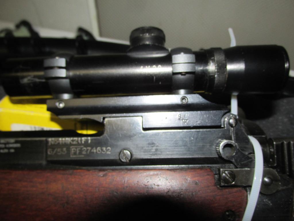

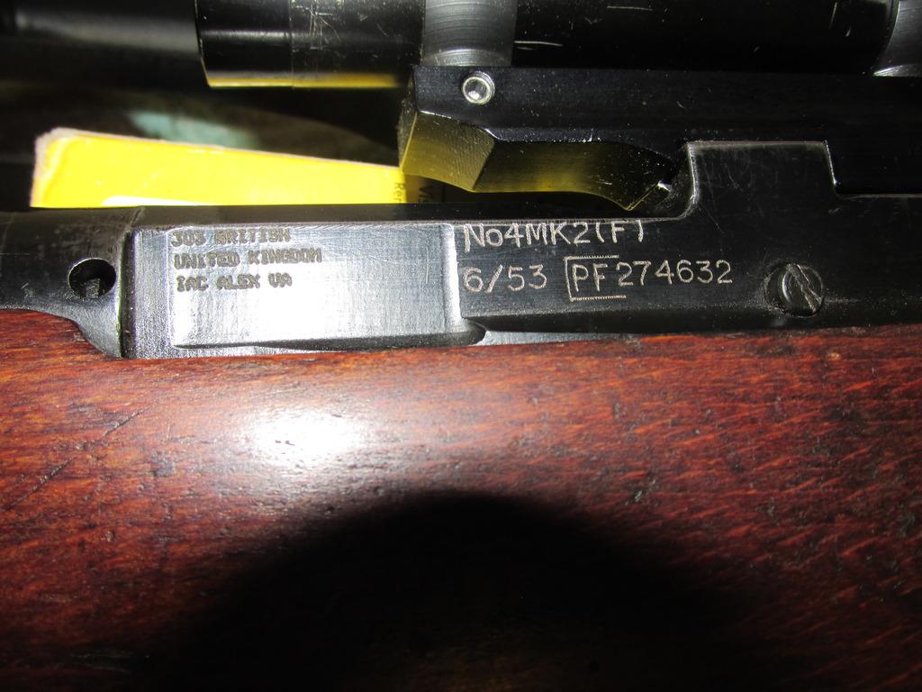

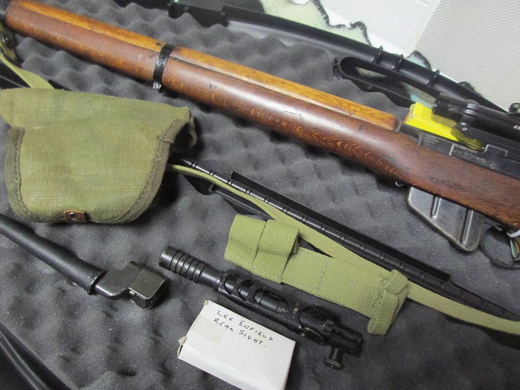

    Picked this up at right price. 250.00 Do know scope is wrong. but rifle came with bayo an frog, grenade launcher, complete correct rear sight. sling an action/scope cover. bore is clean an sharp. matching numbers so far still need to clean. what can you guys tell me from numbers. Thanks Mike

    Which numbers? Scope or rifle? 4 power scope with a 20 mm objective lens. Rifle made in June of '53... Is that an S&K scope mount? I had those before and they worked fine. We have a member here that uses on for his made up "T" and it works fine too.

    Was wondering about the letter F meaning. not sure if it is a s&k mount will look.

    F = Fazakerley, in Liverpool, Englandicon

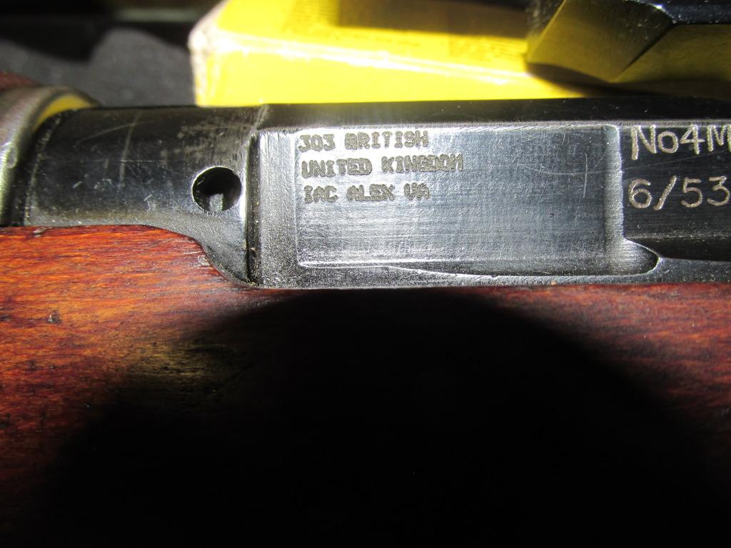

    The serial number sits in the 1951/2 era.
    I cannot read the words on the left of the receiver, can we have a better picture please?
    Looking through my research I have that serial number listed in this block:
    PF 219799 PF 275947 N/K 56,148 (N/K = Unknown customer)
    Mick

    1953!
    I read that as 1956 in the first picture.
    Mick
