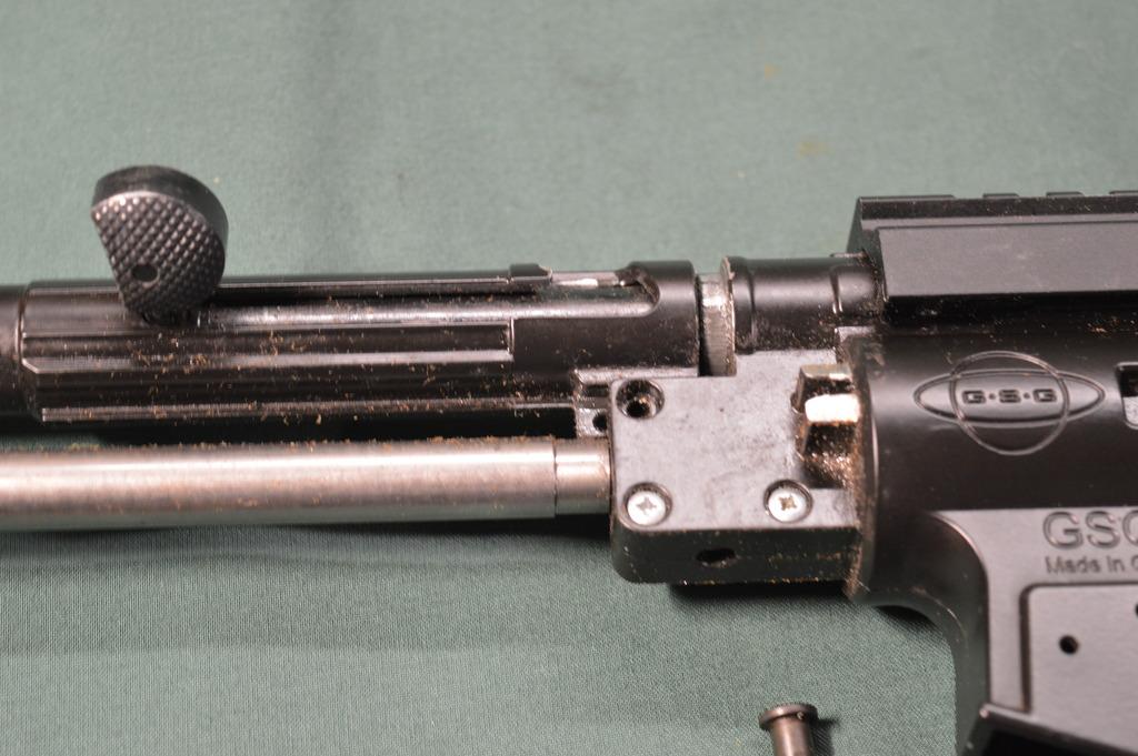

    It doesn't really need words with the pics, but the socket the Butt fitted into required some work and not as easy as the Guy I'd seen do (have included a link to his conversion) I had to make a forming tool to open up the socket a few MM and then use heat to bring the back end out and pull the front in, worked quite well..... some pics below, the butt transforms it straight away, I was going to do the same as the Guy in the link but I will reduce the hand guard to replace the plastic one and keep it compact.
    So what you get in the package
    alongside the GSG
    Some cutting, tweaking and a file it was eventually a good fit...
    Just the hand guard to cut and make good, I was going to extend everything to use the hand guard as is but to keep it compact it still looks good.

    Further progress made today, The hand guard was cut and had to use the dremil to take out some wood so it would locate properly, the problem is to get to fit snug the screw holding the cocking tube had to be removed and the tube slid forward so the guard would fit in, I could of cut it shorter but wanted a good fit, so it will need an access hole drilled in the left side, apart from that it went well and fits like like a glove, over all very pleased, totally transforms it.
    The silencer tube is just for show and cosmetics, *the barrel is thin and could also be cut back 4" if I permanently fixed a bar from the rear going through the stock, as this would keep with in the required overall legal length which I may do later on...
    *(if the barrel was shortened to the minimum of 12" and the butt stock removed its under the legal size of 24" and could be fired different story if it couldn't be used)
    Just happy to fit the hanguard at this stage, some tweaking to do here and there, need to sand blast the socket for the butt, phosphate and paint, trim the hand guard at the rear or chamfer so doesn't look like its just had a saw through it. Also need to make a plate that fits in the rear of the rifle that secures the bolt assembly and find a small spring to fit in the ejector.
