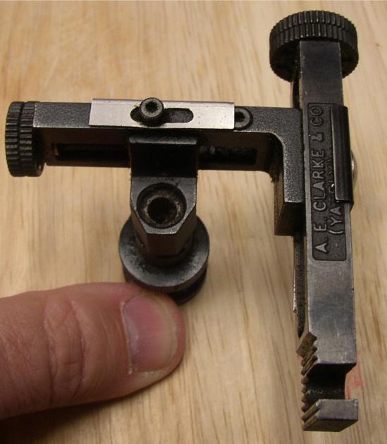

    Thanks guys. Still cruising for a mounting plate. While doing so, I ran across another sight which looks a lot like the Central..an A E Clarke sight?
    Are these worthwhile?

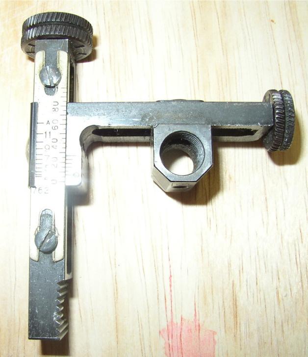

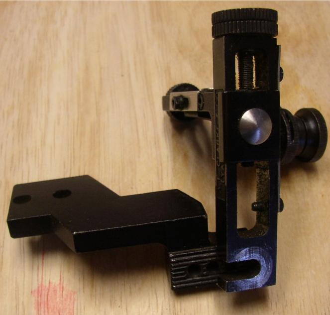

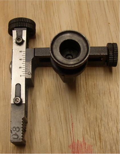

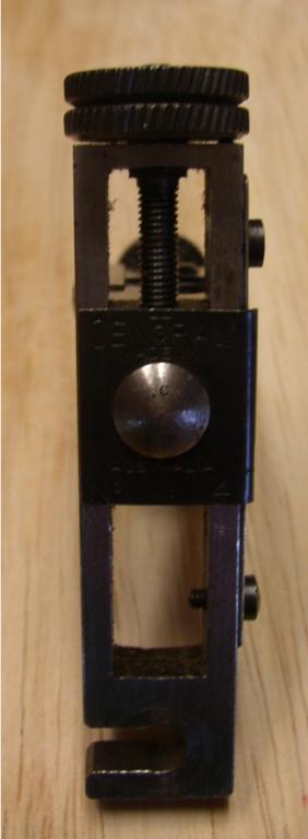

    Just returned from a short vacation and the Central and the A.E. Clarke sight both arrived in my absence.
    Here is the Central;
    Here is the Clarke:
    Amazingly similar. The Clarke came with a mounting plate. Anyone recognize what this plate would fit?
