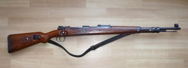

    Hi, I use N140 on the k98 and N150 with Gew. 98 and Persian Mauser.
    Bullets FMJBT from S&B mostly, 196 grs. Sometimes I use Hornady 196 or Nosler 200, but that's almost jewelery, so I normally don't.
    OAL 81,0 mm for both k98 and Gew, while the Persian does not like longer than 80,0.
    Loads: N140 45,0 grs, N150 46,0. A guy who shoots with me uses 48,5 of N150 on the Persian Mauser, but the results are comparable with mine, so I don't see reason for a stouter round.
    The accuracy is very good with both loads, and there are never signs of higher pressures or other issues.
    Primers are Winchester LR.
    These are really good reloads.

    I checked and it's right. Actually I got the reloading data by trial starting from an article on a gun magazine. Just the OAL has been the result of testing on my own.
    I'll also try and see if I can get the Persian to digest 81,0 mm, so I can keep the settings on my dies. I might have had a slightly low neck tension when I first reloaded for that rifle, which caused a bullet to get too deep into the case while loading.
    Somehow I sensed that there was something not going the right way and removed it before shooting.
    I'll make a few tests sooner or later.
