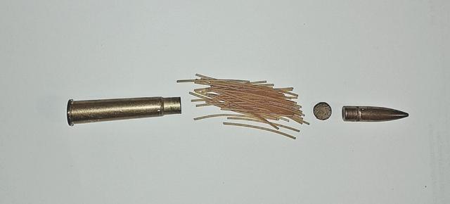

    I use to salvage bullets from (corrosive primed/cordite loaded) WWII ammo before handloading them with modern primers and powder. However, I tumble pulled bullets prior to handloading until they come out shiny. However, I've noticed that the original bullets carry a grease groove which is also cleaned out during tumbling ; then, after being sorted in weight lots, they shoot quite accurately on top of N140/40.0, though. Am I wrong in tumbling the bullets and should I preserve the greased groove ?

    The cannelure is not a grease groove. It's there to aid guide the crimping.

    It's still filled with grease, though...

    I think what you're seeing isn't grease but a sealer to make them waterproof. Most if not all factory loaded military ammo will be sealed.

    True, it could be sealing wax indeed. Then, I guess it's of no importance in reloads whether bullets are tumble cleaned or not ?

    No it's not important. It may increase the accuracy of the bullet a little bit without the sealant on them.

    It's more like a tar coat to seal. I used brake cleaner sprayed on them and then polished them in a big towel before using them. All the tar coat came off.

    It is grease . Since the Enfield was a low powered action they did everything they could to get more velocity and keep pressure down . An undersized bore riding bullet , slick jacket material , and a lubed bullet . It is not a sealer , that is why there is a grease Groove .

    Comment. Never seen any military or commercial jacketed bullet requiring grease; crimping cannelure yes. Never knew the Enfield was a low powered action either, or about the "undersized bore riding bullet". Could you provide some facts on this please.

    The Enfield bolt locks by the middle of the bolt on the receiver bridge , it has no locking lugs . The proof would be looking at it . And no the little lug ion the rear of the bolt is not a locking lug , it is a cocking assist .The proof would be reading the original patent description . . The Enfield was originally a black powder action , was later used with low pressure cordite and it was not even cleared for Nitro powder except for war emergency . Read original Britishicon military ammo test reports .The groove dia is around .314 on the average with a .3095 dia bullet . Again the proof would be measuring real rifles and bullets . Bore riding was used my all militaries in their early small bore rifles . Again just look . I have a vast collection of original ammo and the crimp is not at that groove and the grooves are all full of grease . Again for proof just use your eyes .
