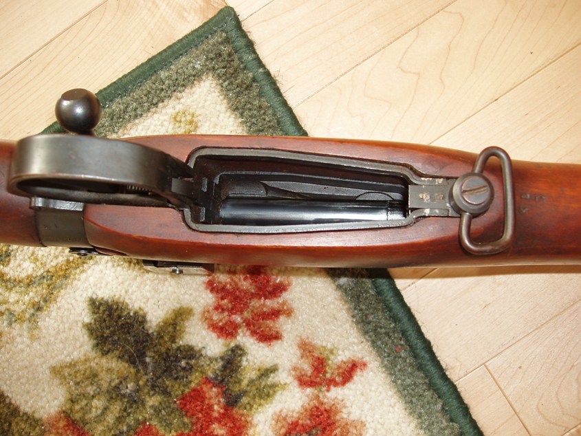

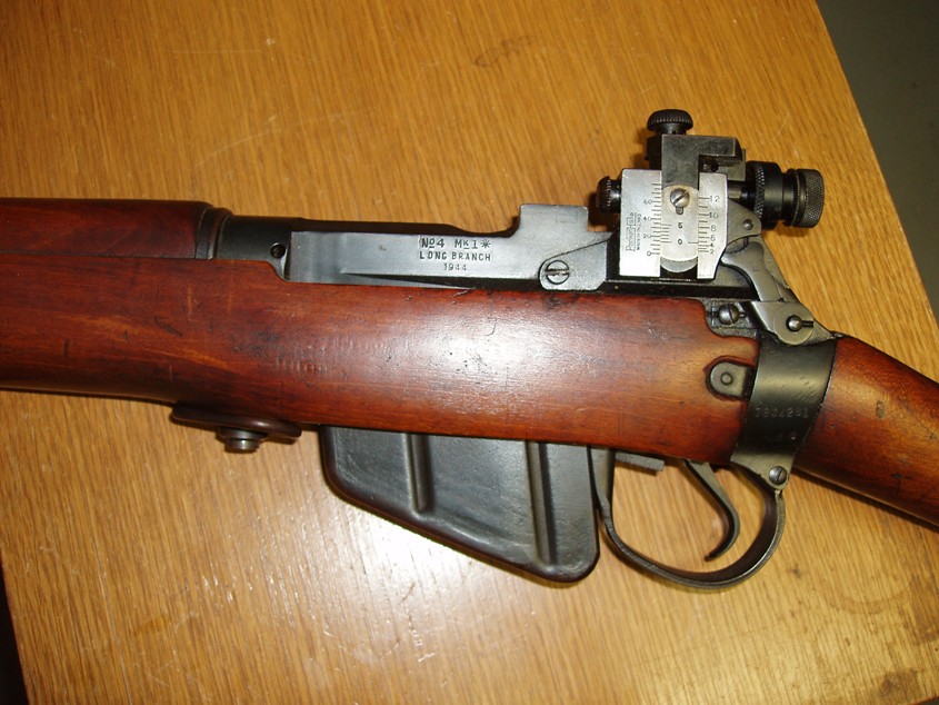

    Hi everyone,
    I know so little that I don't even know if it should be called "Target Rifle", so that should be an indication
    Acquaintance of mine acquired this 1944 LongBranch No4 Mk1* equiped with a Parker-Hale 5C rear sight. What info can I bring to his attention? Where can I read about it? What should I look for on the rifle for any positive identification?
    Thanks...

    Lou, there isn't a lot to tell really; if the rifle had been used at Bisley pre 1968 then it would have shot in the class SR"b", all other Lee Enfields with "issue" sights would have been classed as SR"a".
    The story of Lee Enfield target rifles only really gets interesting when you start to look at post 1968 converted 7.62mm target rifles and the differant builds utilising differant stocks with higher combs, a good example of this would be the L39A1 fitted with a butt from a No8 ·22 trainer.
    In the picture we can't see the foresight, is it "as issue", or does it have a foresight "tunnel"?

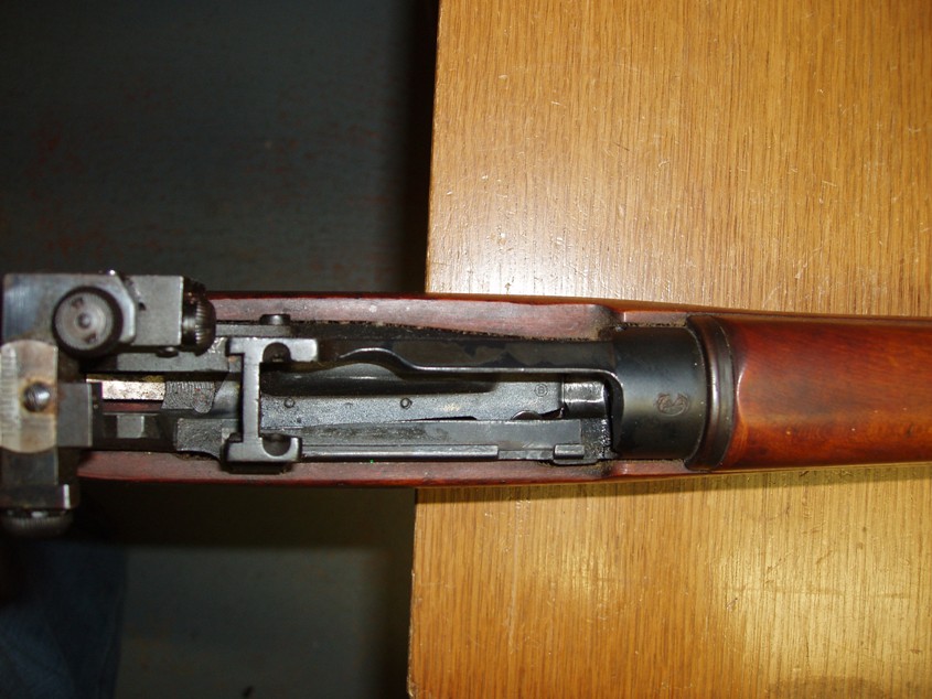

    Lou, check to se if the barrel is marked CMk3 on the Knox form. If so, then it has been fitted with one of the 6 groove "bren" barrels.

    and PS thats one expensive looking eyepiece, the one I have is an iris like a traditional camera shutter. Costly to make I bet.
    West side
    5,028
    05-18-2025
    09:16 AM
    Nice Canadianicon government sale mark on the reinforce. That coloured filter on the backsight reminds me of a school friend's father's No4 target rifle. First one I ever saw or held and it was a beauty. He was a crusty old vet who used to keep clips of ammo on the picture moulding at strategic locations around the house in case he had to repel boarders - not very likely!

    What is a No 4 target Rifle ?. You have what looks like a Club Pattern target rifle, the pride of an individual shooter and possibly his club Armourer.
    One subset of my Lee Enfields is the Commonwealth target rifle - at least the variants found in NZicon. Having started out as a NZ NRA Target shooter in 1965, the acquistion of a target rifle was easy - either you paid (Pre decimal currency) $92 for a "Regulated by Fulton" No4, or you paid your Rifle Club membership fee, got a certificate to that effect, went to the nearest Police Station and asked for a "Permit to Procure" - in later years, I was to wonder at the name - the said permit permitting you to obtain a rifle. You then went to Trentham Camp Ordnance Depot and paid $10 (Used, serviceable), or $20 (Never Issued) for a No4. Both my first two (Used) had immaculate barrels and were Longbranch 2L and 3L series. Within 28 days, I had to take them to the Police station and Register them (cost $1) - for the UKicon readers, both the Permit to Procure and the Registration were just paper transactions, no restrictions, no inspections. Some shooters used the rifle with 5c sight put on just as issued. By far the majority took the other path, into Darkness and horror.
    Now the horror. The rifle was handed over to the Club Armourer, who rasped out the barrel channel to free float the barrel, drilled out the brass rod at the rear and substituted a long machine screw and nut, put brass shims on the Draws, adjusted the trigger, ensured that the Knox form bore properly on the wood, packed the side of the action cutout with Brown Paper - varnished - and put in a wood bearing at the 11.5" mark on the barrel - epoxy Plastibond was a godsend in a few years. My part in these proceedings was limited to purchase of a Parker Hale 5C sight and purchasing a 1/2 gallon Flagon of beer for the Armourer.
    Both rifles shot rather well - better than myself. Later acquistions included Rifles stamped by Fulton, ParkerHale and AG Parker and 4/1/2 and 4 Mk2 variants.
