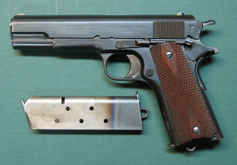

    I don't know that there is any evidence to show that Break-Free will remove any blueing. I would contact the makers of Break-Free if I had any doubt. Remington Arms used rust blueing up into the 1950's and possibly the early 1960's, and surely someone would have noticed that Break-Free was removing the blue from their rifles and shotguns if there was any problem. I haven't used Break-Free in quite a while, but I feel certain that some of my rust blued guns were protected with Break-Free.
    The Springfield 1911 was rust blued.

    Thanks for your advice, That is one great looking 1911.
