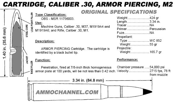

    The bullets you have are, from the description, M2 armor piercing. As the bullets have a cannelure, you should probably seat to the same length the Army did.

    Check that out! Very helpful. Thanks!
    Any thoughts on the powder charge? I'm not certain how large of an impact one grain has one way or the other.
